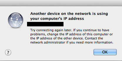

Not sure why, but im regularly getting this message.
Is it difficult to change an IP address to stop this re reoccurring?
Thanks

I don't know if this applies to your situation, but when I was getting that message frequently it turned out the problem was that my Time Capsule, which is my wifi source, was dying. It had nothing to do with others using my IP address.
I was also having problems dropping my wifi connection, and other glitches...so this may not apply to you.

Have you made a change to your network ? Added/Removed some bits ?
Best way to fix this (once time) is to reboot everything in the order :
0. Modem
1. Router
2. Switches etc
3. WiFi Access Points
4. LAN items
4. WiFi items
Wait till each step is complete
Difficult to diagnose the problem without more info.
What device as acing as the NAT?
What other devices are connected to the network?
Is everything wifi or is there a mix of wifi and Ethernet?
Can you see what devices are connected to your network (and their allocated IP addresses) there are lots of tools for this both for computers and smartphones.
Simple solution maybe to just setup your network from scratch if you only have half a dozen or so devices using it.
But to answer your question if you have the privileges to access the network setting in the router/ NAT you can specify IP addresses to certain MAC's. For most users it is simpler though to have then allocated automatically.
