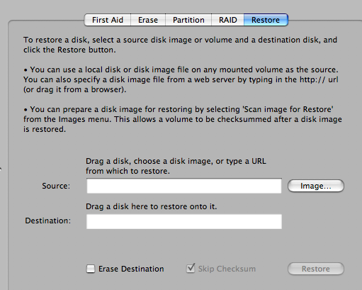

I usually use disk utility (RESTORE) to clone the disk and then go into system preferences - Startup Disk, select the new drive and click Reboot.
