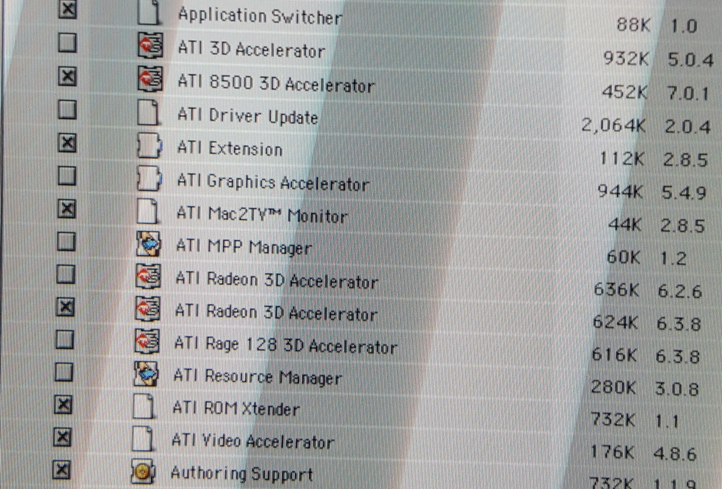

Secondly, for the current extension set I'm using, extensions manager is showing 'ATI Extension' checked, with a version number of 2.8.5, 'ATi Driver Update' and 'ATI Graphics Accelerator' are both unchecked.
The ATI ROM Xtender is normally the one needed, just make sure you are using that latest version you can get.
The ATI Driver Update, I think can also preform same of what the ROM Xtender does.
Here in basic terms is what they do, on the graphics card itself, you have an FCode ROM that has a Native Device Driver 'NDRV' for Boot Services and the Mac OS Runtime Drivers.
The ROM Xtender can override this graphics card 'NDRV' with a newer version, a way for ATI to fix issues without updating the FCode ROM of the Graphics card.
Normally the latest update would be ATI OS 9 Mac Software Update January 2005, however there is a later OS X only ATI Driver package that installs a newer ROM Xtender that can be used in OS 9.
Also, I can make a custom 'NDRV' for any ATI graphics card using the last set of 'NDRV's for Leopard 10.5.8. These may or may not fix your issue.
