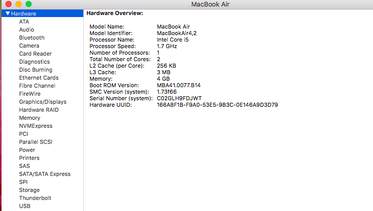

The last one definitely won't work as Apple has no drivers for NVMe drives,
Don't know how this jibes with your "no drivers" note above but my MBA lists NVME
Can you give more specifics, like the model numbers, of the drives that work and don't work? Can you post a photo of the System Profile entry for the Intel drive?
I don't have any plans for them and am happy to give them away to anyone who needs them in the UK. Having said that, it wouldn't be any more expensive for anyone to get them from source considering postage in the UK. I think these are a tad too thick to go as letter post so may attract parcel mail.
As for the NVMe in SysProf, I think these must refer to the chips in the latest MacBook Pros, which seem to run at NVMe speed, except that Apple never adheres to standards, so even if Sierra supports them, you would probably need a firmware patch or additional drivers to get a standard NVMe to run but even then, probably only as a data drive. The numbers of PC motherboards that support booting from NVMe is very low, too.
