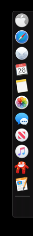

View attachment 937724View attachment 937725
UPDATE - changing the SystemVersionCompat.plist from 10.16 to 10.15 does allow LiteIcon 4.1 to launch and it *does* in fact change any 'drag and drop' app icons after the auto cache clear and log back in. The trash can icons can be changed as well but not the Finder icon. I didn't test all of the other icon categories, like document files...but the system folder icons (I so wanted to change) *are* in fact replaced by LiteIcon, contrary to my previous posting, but the changes for those currently don't get applied. I'll keep looking for ways to make this work and report back if I find out how.

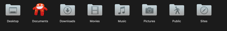

My new Big Sur Folder Icons System
I am working on compiling instruction but am still failing specifically around replacing System Folder Icons. I’m keeping up with the latest efforts and suggestions over in the Macrumors ‘Big Sur on Unsupported Macs’ forum first and foremost.
