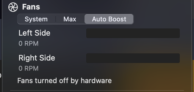

It's not about what speed the fans are set to, it about the fans being enabled so they can turn on. I see this at the top of the menu:
Even if I have the fans configured to set to 2000RPM when any sensor is >40 degrees celcius, until the laptop gets 'hot enough' for the hardware to enable them, TG Pro can't do anything about turning them on. I don't know how hot it needs to be before it will let the fans come on, but it's definitely above what I want it to be.

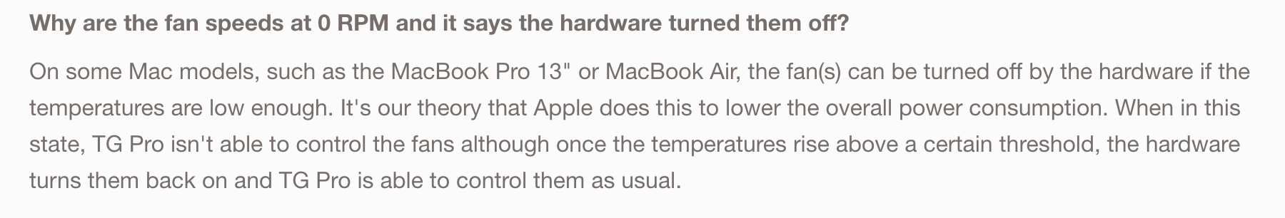

They also list this in the FAQ:
Although the m3max doesn't appear to be listed.
