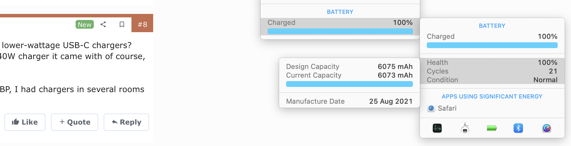

There is no risk in my experience - I use a 30W MacBook Air charger for my 14" M1 Max, most of the time running the Mac while charging. Even while under considerable CPU load, max memory usage (64GB) and driving an external monitor the Mac still charges slowly. The battery health is still excellent after 21 cycles and 3 months of use - hard to put complete cycles with this sort of battery life.

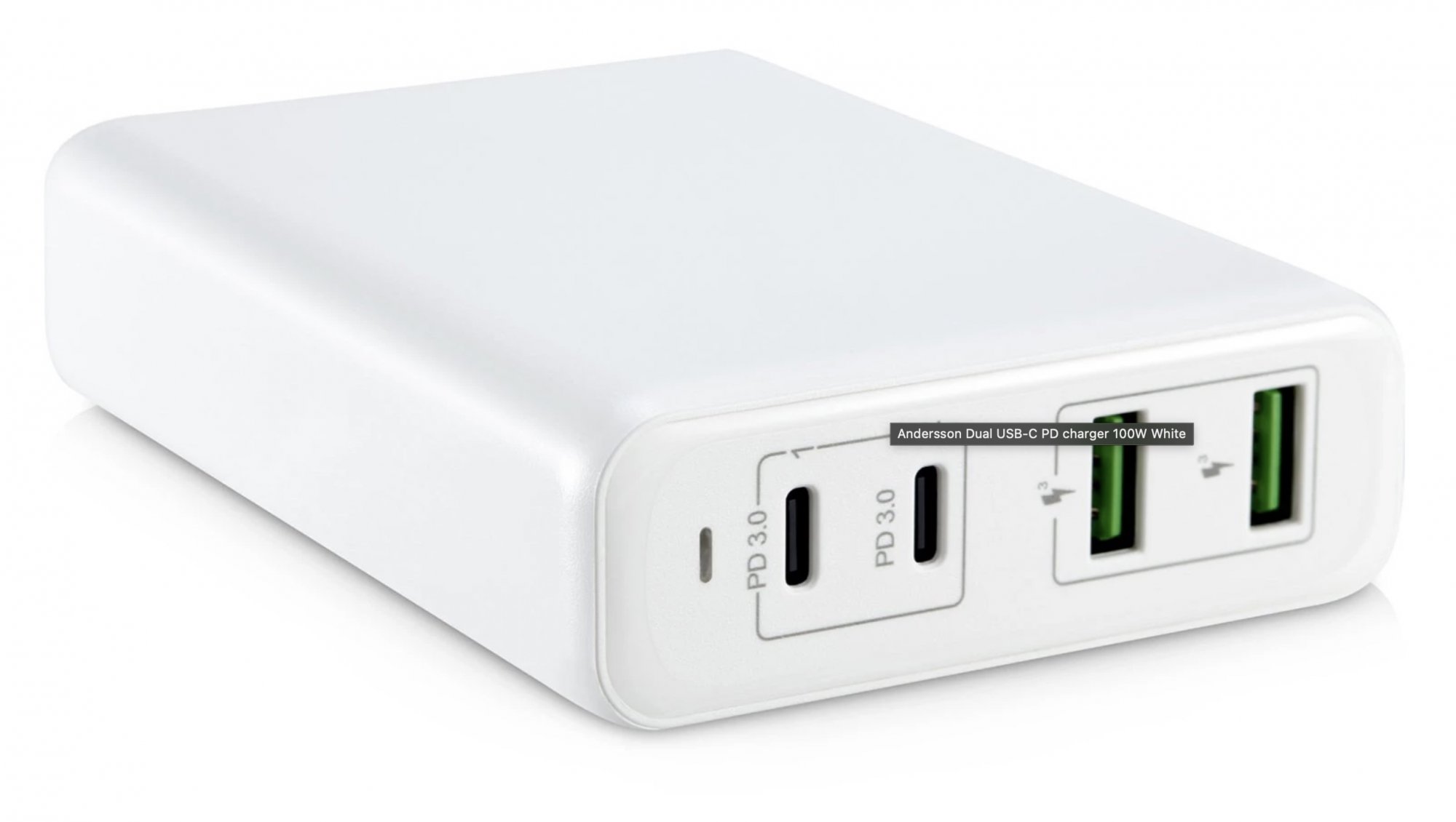

I'm seeing a curious issue with a third party 100w charger. Its branded Andersson and also sold under other names. It has two USB-C and two A ports. Works fine. Unless you run the Mac at full tilt.
During intensive export/render sessions in Premiere, the Pro 1 Max will peak for short intervals at up to about 120w power draw (according to istat). That Andersson charger will basically stop working, and I have to replug it to the wall socket to get it going again. Some kind of internal safety/fuse going off I guess, even if its rated for 100w over USB-C and shows up in hardware info under "Power" as 100w. Charger doesn't get unusually hot.
Of course the Mac doesn't hiccup at all.
Yes, yes. Don't use 3rd party stuff yadayada. The convenience factor of the multiple ports is unquestionable though.
