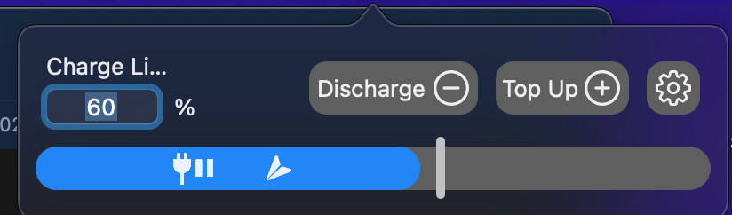

So the "Discharge" button works fine on Intel in Clamshell?
