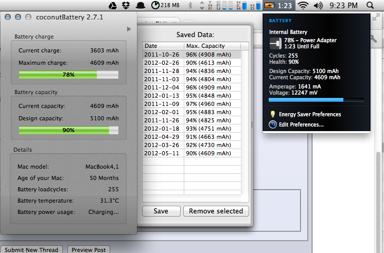

I have attached with this post a picture of cocunet Batt and my Istat Bat Reading. They seem to be the same.

Problem is that is 100% fine. Why fix something thats not broken? I had the same charge problems with the apple one. Also, I oped both up and they have the same parts.
Also OWC is trustable.
