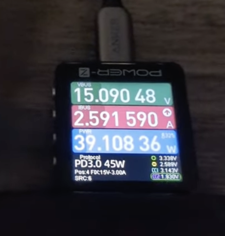

There's a YouTube video showing a charge rate of 39W.
Charger is showing PD3.0 at 45W (15V @ 3 Amps)
