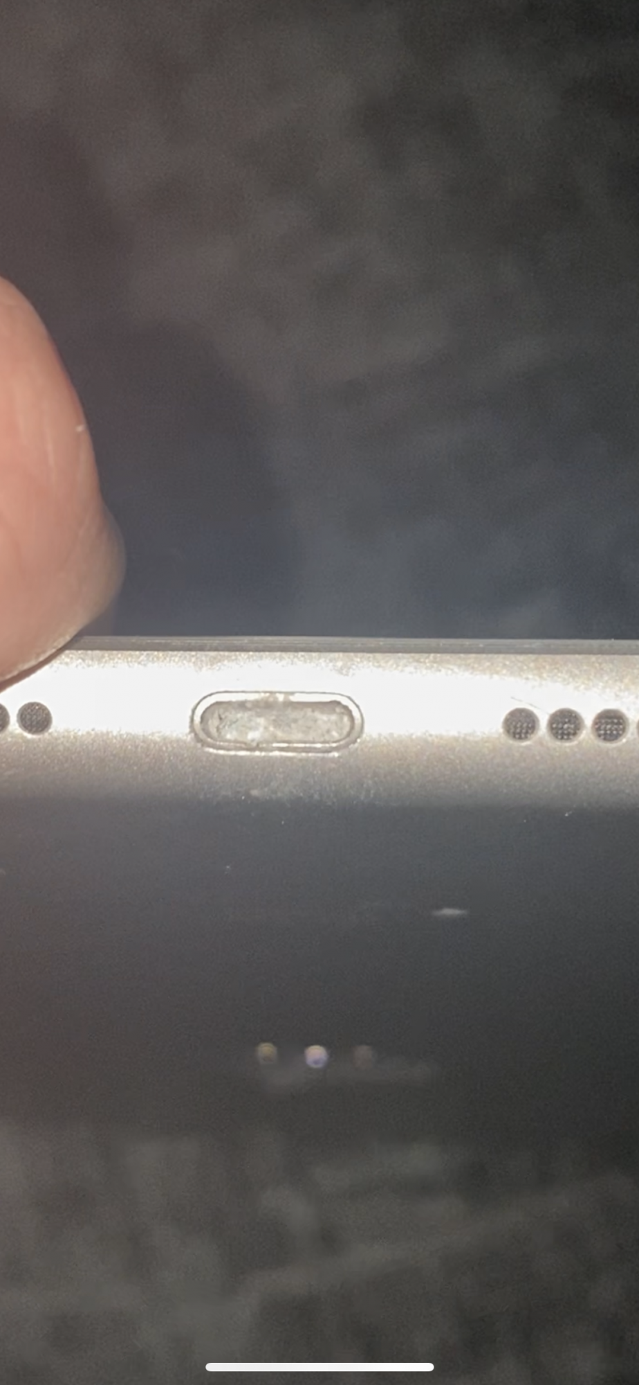

Hi all, my son has an iPad 8th Gen (2020) and we found today that part of a Lightning cable had snapped inside (not just a small fragment, quite a lot). My prior experience has taught me to try using glue and to try to pry it out, but I’ve had no luck at all and it actually looks like the stuck cable end is crumbling!
The iPad is still under warranty but I’d be very shocked if this warrants a free replacement, so I’m willing to try anything else to get it working.
Any tips?

I would contact Apple. They may show some mercy and repair for free. If you try the repair yourself, you may make the problem worse.
I’d contact Apple first and show them your documented issue. Better to ask them first and then consider alternatives if that alley fails. Best success!
Reactions: KayEm6419
Part of the problem is that the Lightning port has a spring-loaded latching mechanism that latches into indents in the narrow sides of the Lightning connector, to prevent it from coming out.
Assuming this was a genuine Apple Lightning connector, it must have taken quite a bit of force to break it, as it is encased in aluminum. I am also surprised you cannot see remnants of the the PCB protruding. (Now covered by glue?)
btw, I have found that third party/fake Lightning cables do not work as well as Apple cables: they often charge much slower and have inconsistent connections. They usually do not have gold-plated contacts. The Lightning cable is not just a dumb wire, it has a chip in it.
get yourself a Dumont Nr. 5 or visit your local anatomy, neurobiology, surgery lab/department etc.… or electronic store, they probably will you lend one for a few minutes when ask nicely. Depending on what kind of glue you used (did this really ever worked?) you will be able to clean out the port.
This is a fairly common repair job for third party repair shops to replace the Lightning flex cable and port. Should cost less than $50 for the job.
Right. Poke a metal forceps into an electrical connector (or for that matter, a metal screwdriver, metal screw, etc.). Let's hear it for potential (pun intended) short circuits and electrostatic discharges, and for harder metals damaging the softer metals that make up the port's electrical contacts.
Whether to remove a broken-off connector or to fish-out accumulated pocket lint, a softer, non-conductive tool (wood or plastic) is a safer way to go. It's true, plastic and wood are less likely to be successful when brute strength may be required, but they call it brute for a reason - what good would an empty port do, if the port is permanently damaged by the "fix?"

If you have an Apple Store nearby, bring it in for an evaluation. If they can fish out the broken connector at no charge then it's a "win." If not, you can decline the repair quote and decide whether you want to shop around for a cheaper repair.

you are of course right. but then again I assumed that the iPad - due to the overall condition - is discharged.
So the OP should let the iPad discharge before doing anything.
This is a lightning port - assuming that you are careful/have some experience working with pcbs&co. damaging the contacts by removing the male-part of the connector which is stuck inside is unlikely. In its current condition documented in the photos and taking in account that applying glue was considered a valid option in the first place, the @JPack’s advice to take it to a shop/professional seems solid.

Thank you everyone - i made a Genius Bar appointment for today yesterday, but told myself they wouldn’t do anything and nearly cancelled itZ I was about to pay a local repair shop (who to be honest I was a bit wary/skeptical of) £50 fix - he didn’t turn up so ended up changing the Genius Bar anyway.
The tech wasn’t hopeful he could fish it but said he’d give it his best shot, 15 minutes later he comes back and managed to fish it out! And it still charges perfectly.
Couldn’t believe they did this for free too, amazing 🙂
