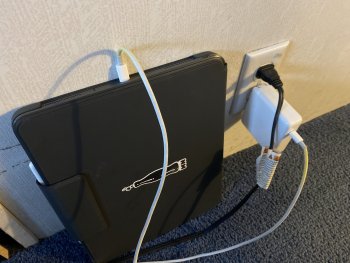

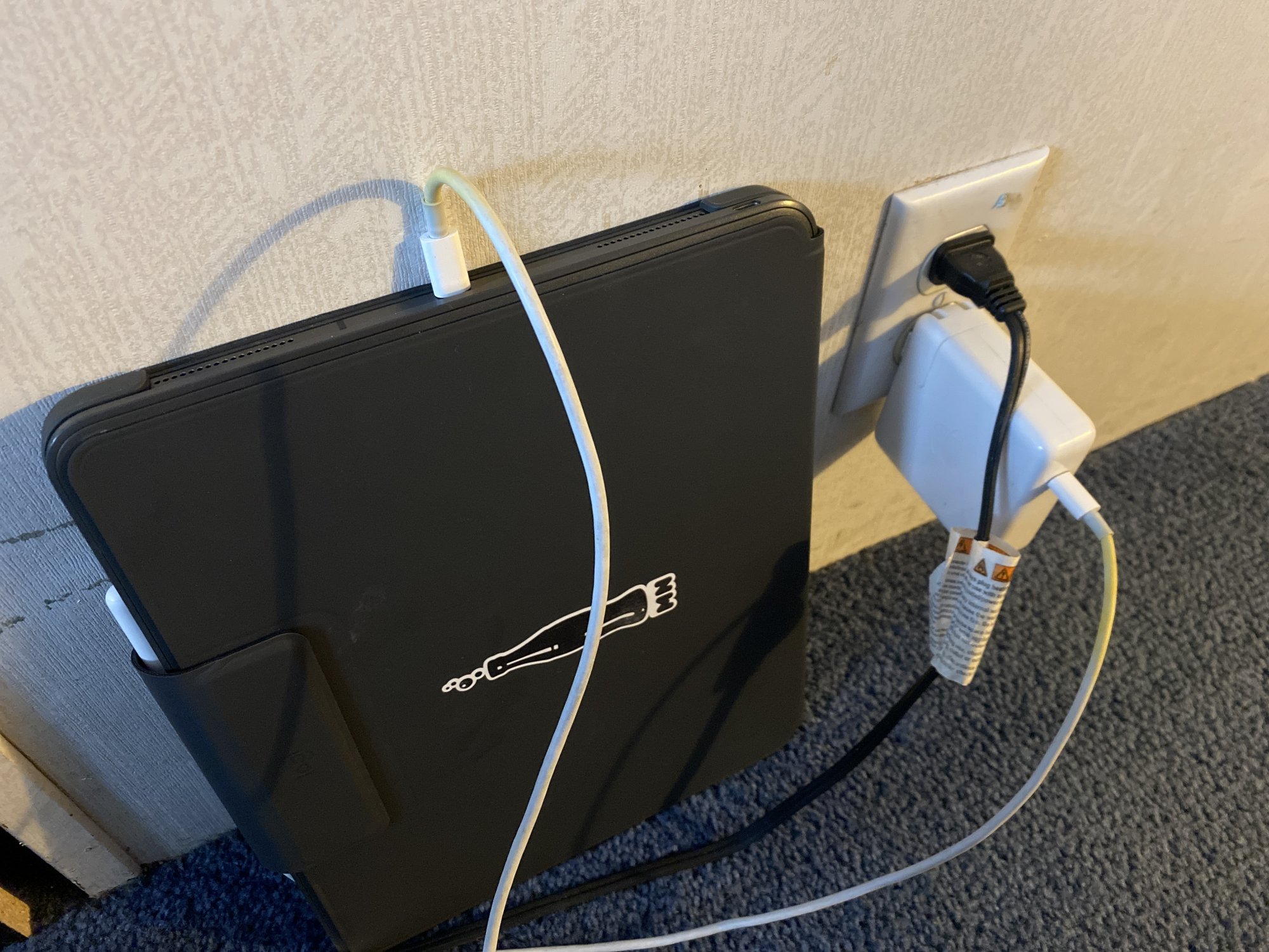

Mine is the same. Is it burning or why is it yellow y’all?

It’s just cheaply made and the material is degrading over time. This has happened to almost all my apple cables or wired headsets over time. Maybe it is easier to see on white cables than on black, but I’ve had phone cases also degrade where they become filmy/oily as well as plastic toys. It takes a while and its different based on the material. If you put on a pair of latex gloves they they will yellow by the time you are done wearing them because of reactions with your skin’s sweat/oil.
This can happen with age and handling. Higher temperatures and UV light seem to accelerate the process, and it generally happening on the ends suggests to me that the oils on our fingers play a role...it tends to also happen with devices where there is not a ton of heat, such as iPhone cables, suggesting heat is not the sole factor involved.
The yellow color itself is not an issue, but it can signify that the outer insulation is weakening/losing its elasticity, it may be more prone to tearing open or permanently deforming, and so it may be nearing the point where the cable should be replaced. This was a huge frustration with MagSafe, but with the USB-C cables it is a much cheaper endeavor given the charging block is now separate from the cable.

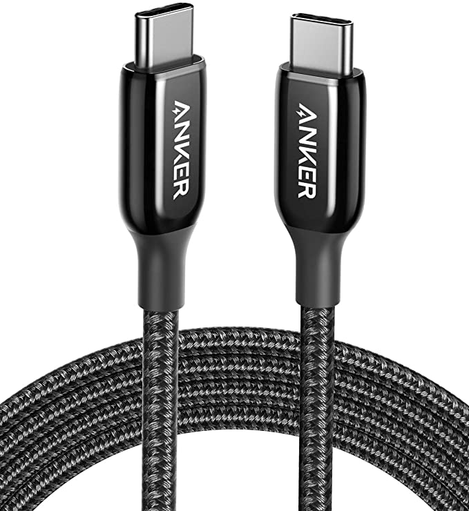

Same... I've never had a MacBook power cable turn yellow. I've had an iPhone cable turn yellow that was in my car and in the sun a lot. For my latest MacBook Pro - I bought an Anker USB C cable and much prefer that to the Apple cable (easier to wrap up and use). A braided dark colored one - expensive but it feels like it is going to last forever.
https://www.amazon.com/Anker-Powerl...ords=anker+usb+c+cable&qid=1613836212&sr=8-12
