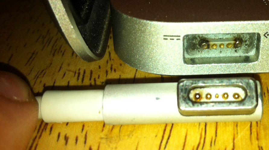

Then Iike a genius, I decided to "look" at may charger contacts, and I found this:
Seriously guys... what the **** is this?

The pins in the cable connector are spring loaded. It looks like the pins in your connector were binding due to some type of buildup, and this resulted in poor contact with increased resistance, causing overheating and charring of the connector.
Use an object on the pins to exercise them. The tip of a propelling pencil that takes 0.7 mm leads is perfect for this. If you feel slight resistance, use a little isopropyl alcohol and work the pins to free them up until they extend fully.
