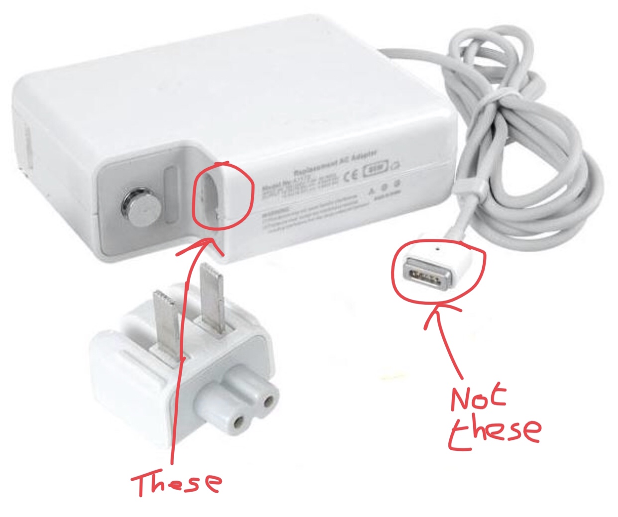

It’s a 2015 MacBook Pro, so not USB-C. I’ve drawn over the below diagram showing it’s the two pins in the charging block itself that are damaged, not the 4/5 pins that connect direct to the Mac.

Well either way, something has shorted between those two pins. It is a rather odd one though, not sure if Apple would be able/bothered to fully investigate. Could be any number of actual causes but the result is Live + Neutral meeting, they don't like each other and will try to weld one another in a little lightsaber battle of powers.
