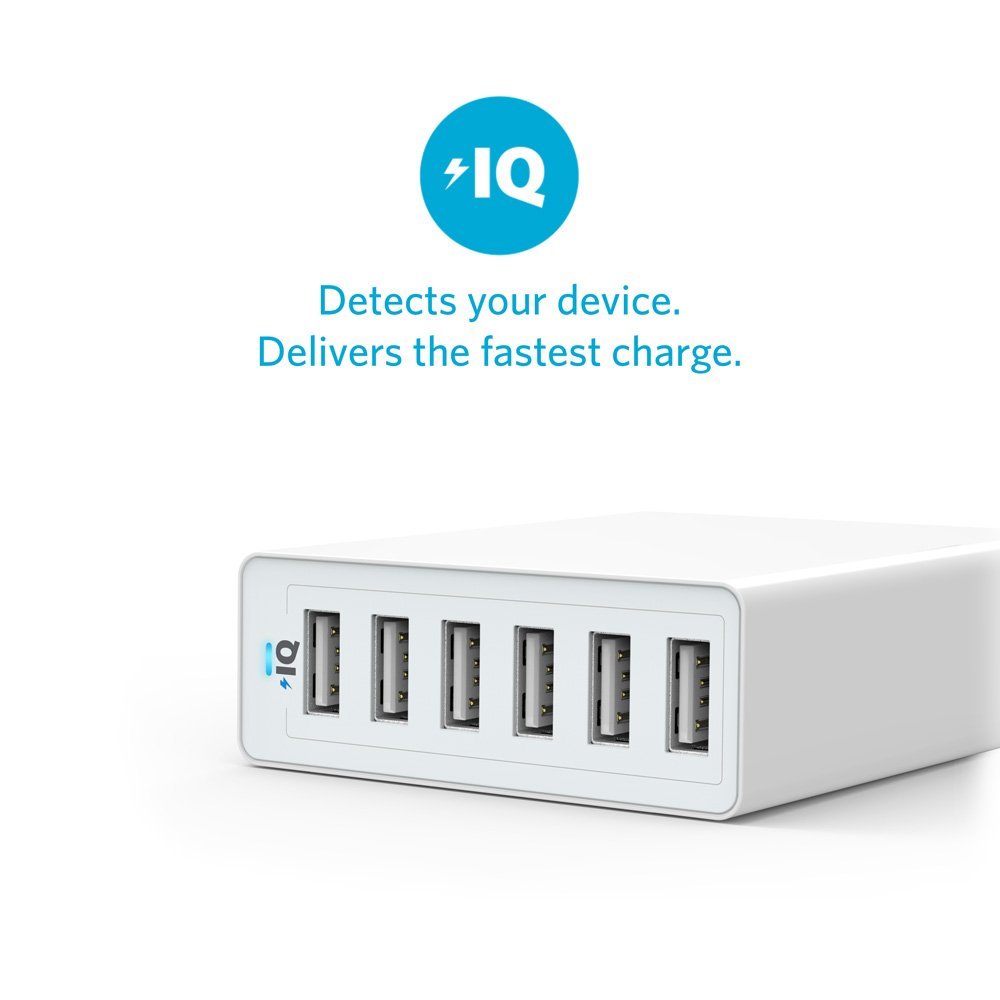

A couple of the reviews showed the MacBook attached to an external battery for charging (or at least slowing the drawdown). I use the Anker charger for iPad, iPhone, Kindle, headphones etc. trying to figure out if I can just plug a USB -> usb-c cable into the same charger for my MacBook
Any thoughts?
I have this one
http://www.amazon.com/gp/product/B00IBDOB5I/ref=oh_aui_search_detailpage?ie=UTF8&psc=1
But they now have this one
http://www.amazon.com/Family-Sized-...gy-Motorola/dp/B00P933OJC/ref=dp_ob_title_wld
Well they both only provide 2.4 amps per port which is 12 watts. I don't think that will power the laptop but it remains to be seen whether it will charge it when off.
