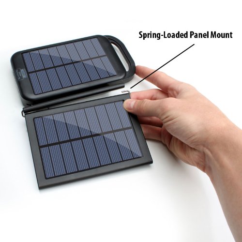

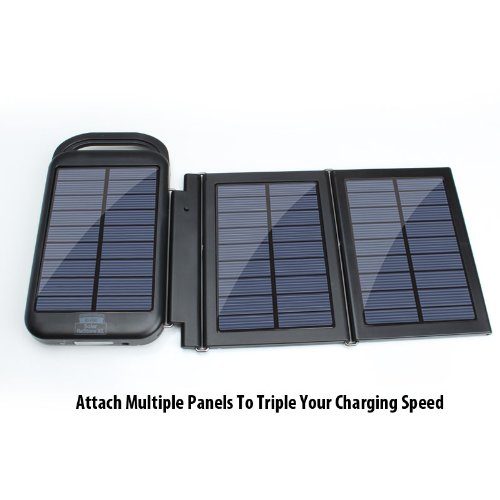

As the iPad Minis battery is 4490mAh, you want the ReVIVE XL+ with 6000mAh.
And if you don't want to put it into direct sunlight for 11 hours a day, you also want the two (or even four) add-on panels to decrease that to 5.5 (or 2.75) hours. It isn't even that bulky:

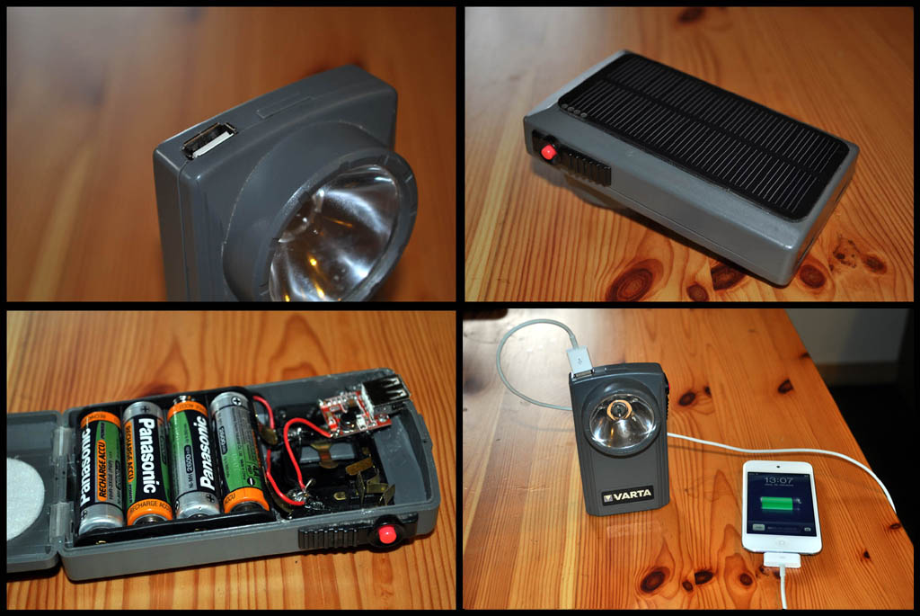

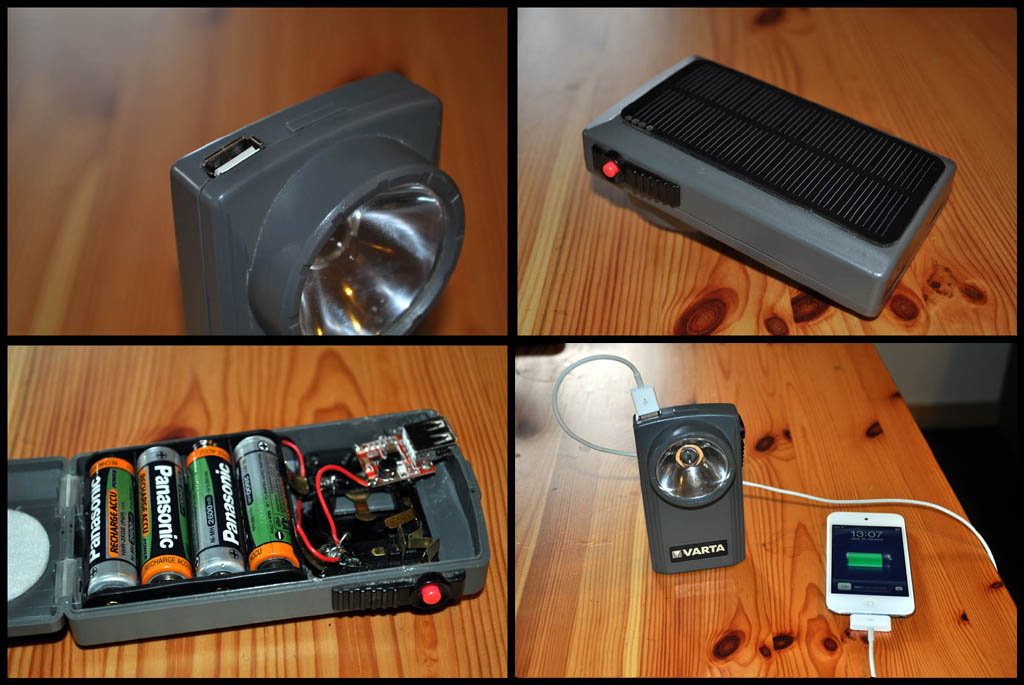

I just build a solar charger myself (see attachment) from an old torch light. On the back I glued a 5.5v 150mA solar panel. It can charge 4AA batteries which you can use for the torch light.
But with the USB DC DC converter I build in you can charge iPhones, iPods and even an mini iPad, though it charges the iPad only 25% in one charge, then you have to charge the AA batteries again...
Of course in the woods won't be much sun, so you might consider taking also a thermal electric charger with you. Unfortunately I cannot find those.
Anyway I don't know your budget and demand but here is a cheap ipad charger for 20 bucks which is similar to my creation or if you need more juice and need it fast, maybe this bigger charger with more power is an option.
Let me know what you decided to use, I am curious!
