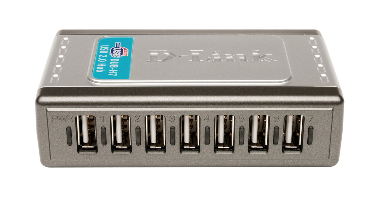

I have 2 or 3 of these…D-Link DUB-H7.
Of course, it's USB2 and not USB-C, but I don't believe the iPhone is USB3 and there are plenty of USB-A to USB-C adapters out there. The hub has it's own external power supply. The hub will provide power while giving you a data connection.
This is the old model, D-Link updated the look of the device later on. But I usually try and get the older ones because they go for about $10-20.
That ancient thing charges an iPhone 13 pro at the fastest possible speeds while also using data? I'm...skeptical of this claim.
You can be skeptical because I didn't say it charges the iPhone 13 pro at the fastest possible speeds. I don't even own one of those, my newest iPhone is an 11 Pro Max.
What I did say was that it charged devices while allowing data use. It does that at the fastest possible rate the USB hub device is capable of.
If you meant that you want a fast charger, like what Apple offers (in a hub), then I misinterpreted your words and can't help you.
