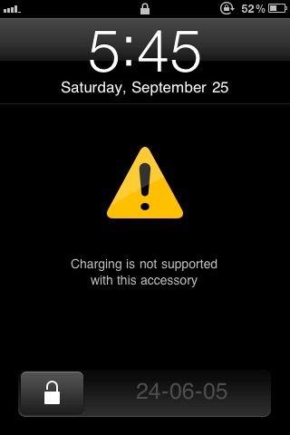

Has anyone got this before?
to clarify I'm using my usb cord to charge on my laptop. anyone knows anything?
Here is the screenie:
I'm having the same issue, using Windows 7, iPhone 3GS 32GB, software 4.0.1, the weird thing is that i can charge in my mother's computer, and also I can charge it under linux with no problems at all...
This is usually caused by insufficient voltage and could be caused by an old or faulty cord, insufficient USB phantom power, a dirty connector, or any combination of these symptoms. It is especially common when using older iPod accessories with newer iPhones or iPads.

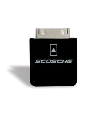

Scosche passPORT - Charging adapter
This fixed my problem with my installed car kit... With this and Popup Blocker, I get no error messages and I can play my playlist thru my car stereo and charge my phone.
