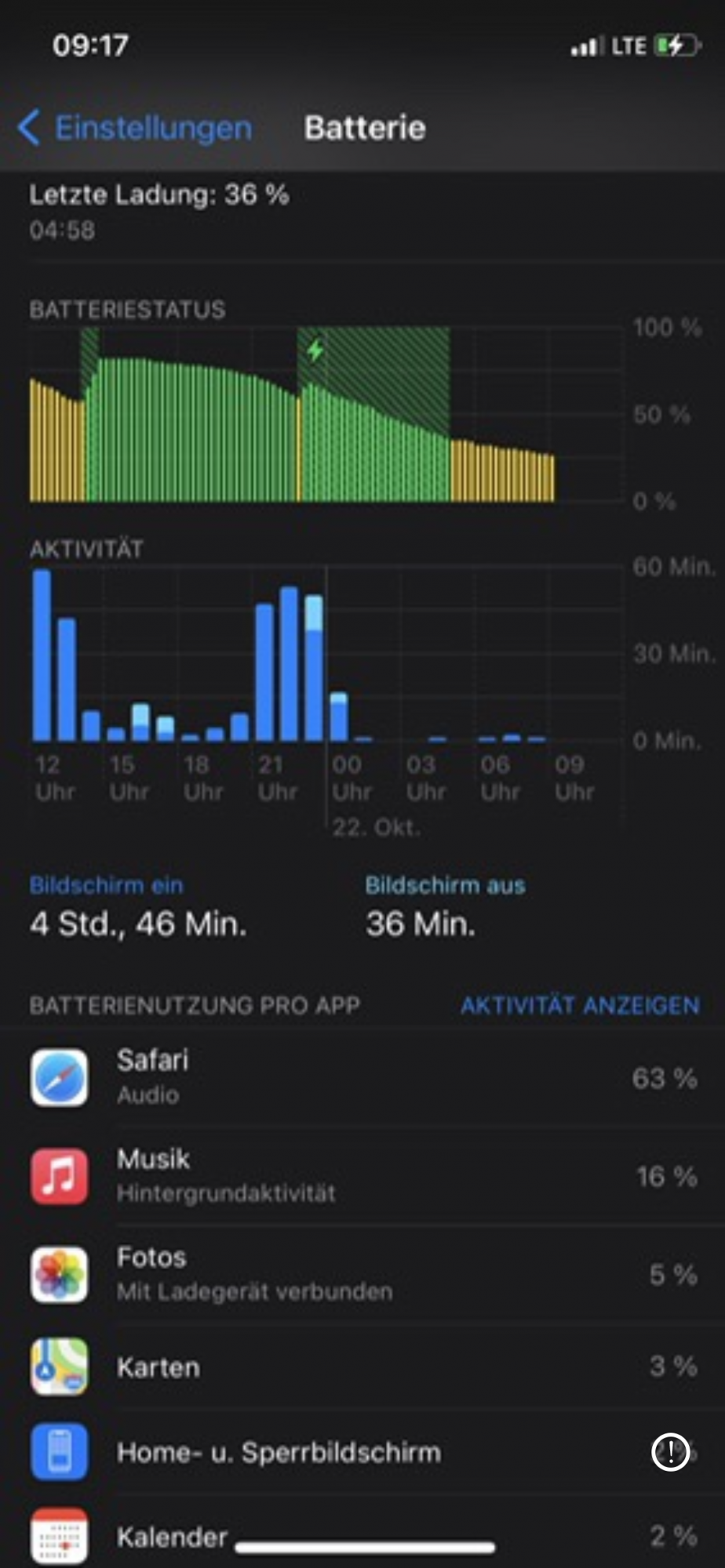

Often my iPhone 12 reverts backwards in percentages when charging using a standard wireless or wired charger. I mostly use the fast charger which works perfectly and what my iPhone is used too. Has the fast charger deflated my battery?

View attachment 1957696I’ve had that happen before, too.
Mostly with an aftermarket charger, but also with original ones. It should be nothing more than a software glitch. At least for me this hasn’t happened in a while. When did it start for you?
No idea as I don’t regularly use standard chargers and mostly use fast chargers. I am on vacation and noticed the problem with a wireless charger on my iPhone 12.

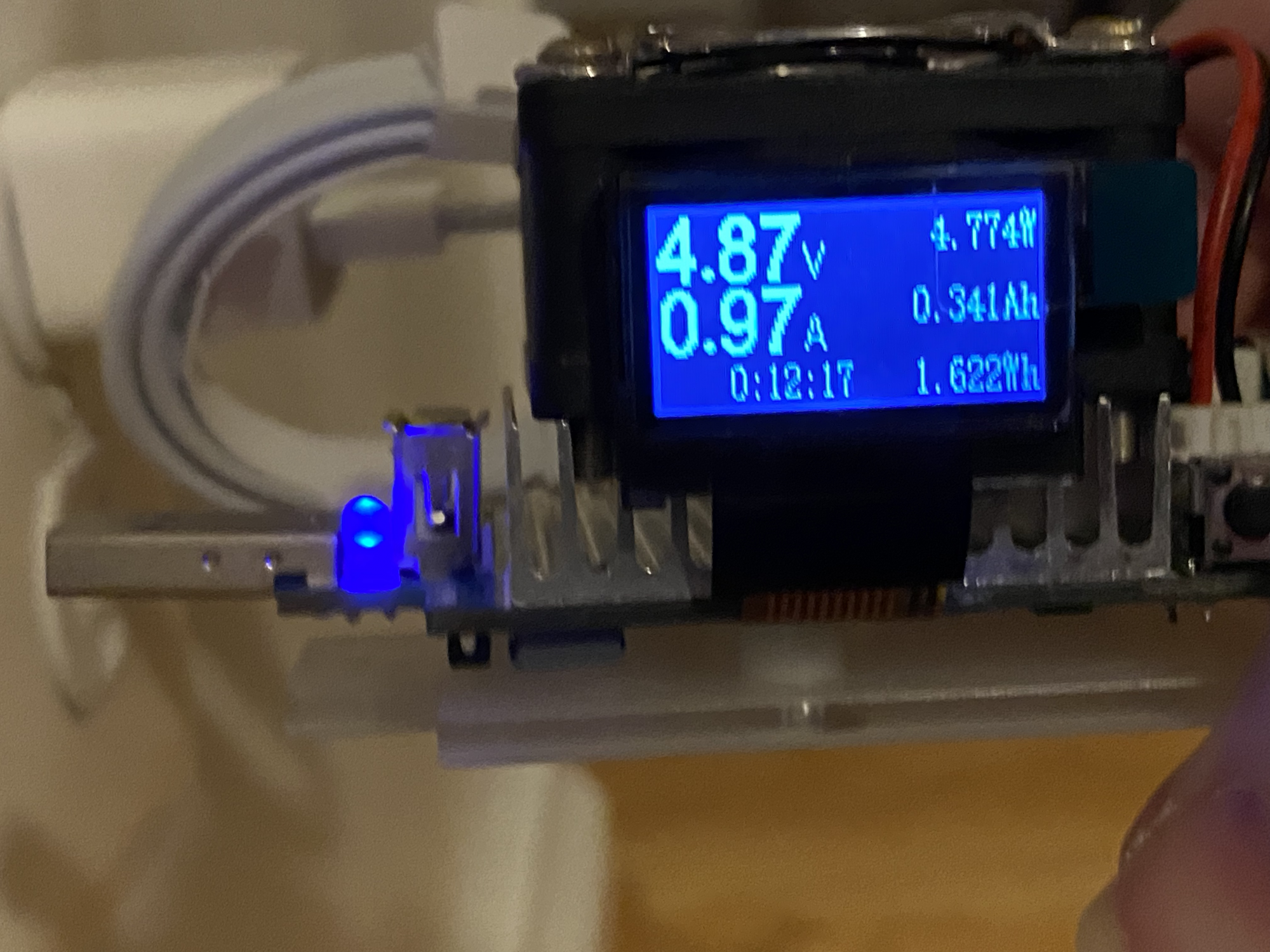

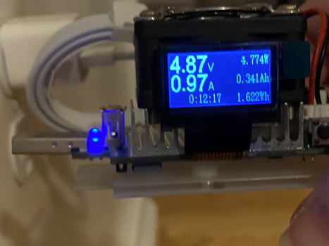

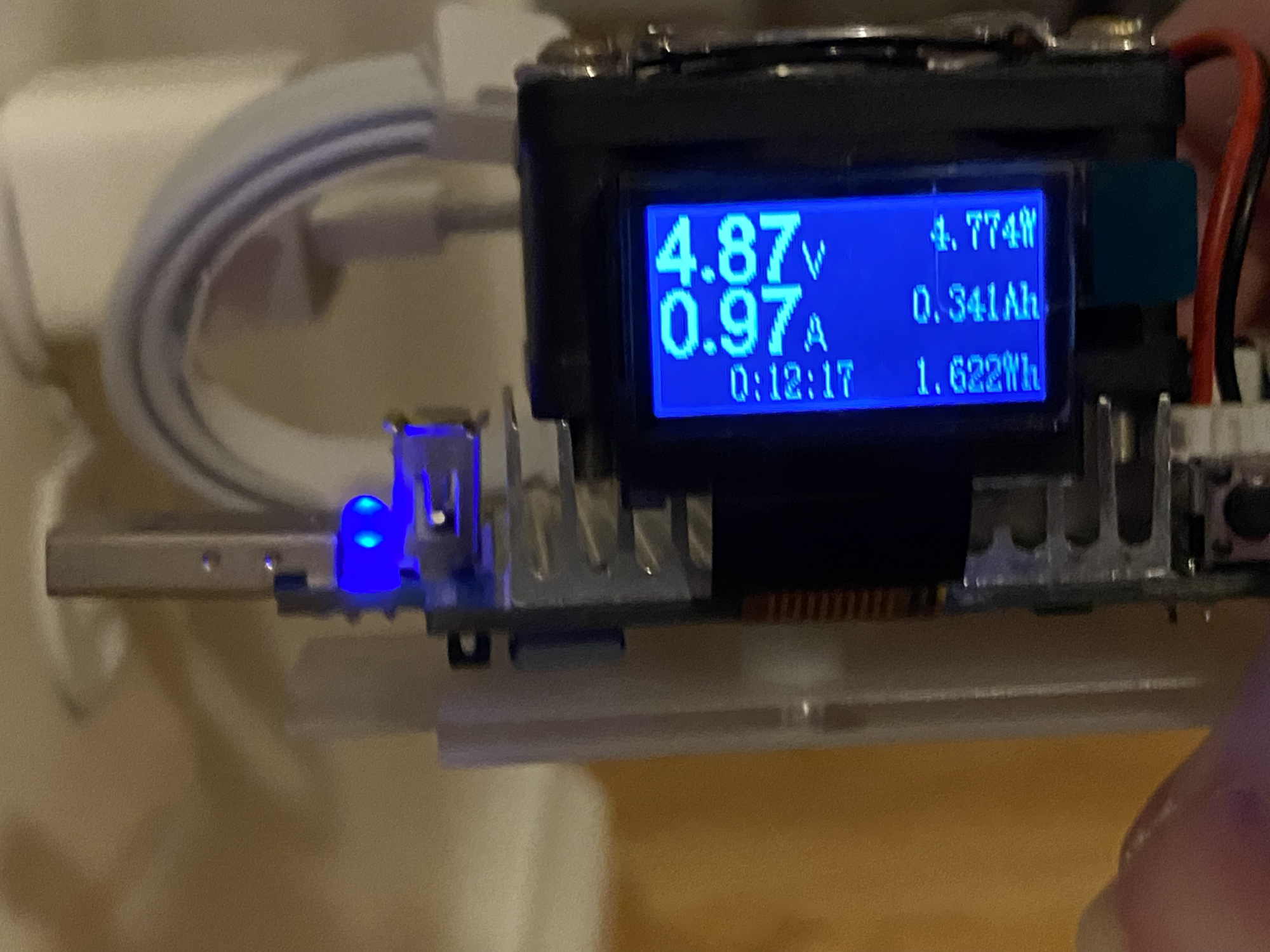

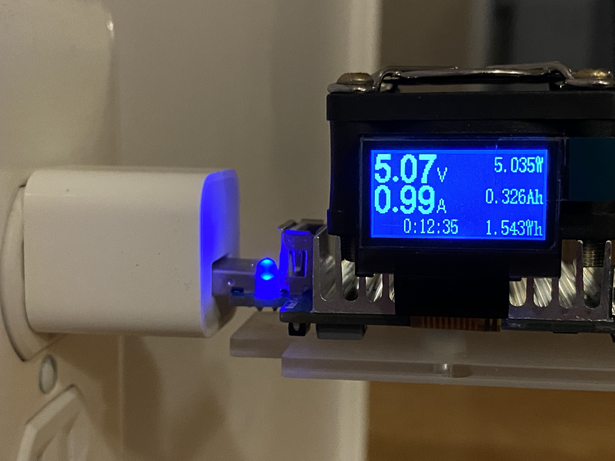

Like mentioned by @now i see it it could be something as simple as a dirty connection or a poor quality cable. Even at 5volt 1amp (5 watt) a brand new Apple 5watt charger and Apple Lightning cable would deliver the full 5watt. It will be 4.5-4.8 due to resistance in the cable and there being connections. That is about the best you'll get from a 5 watt charger without using a 6" Lightning Cable or something.

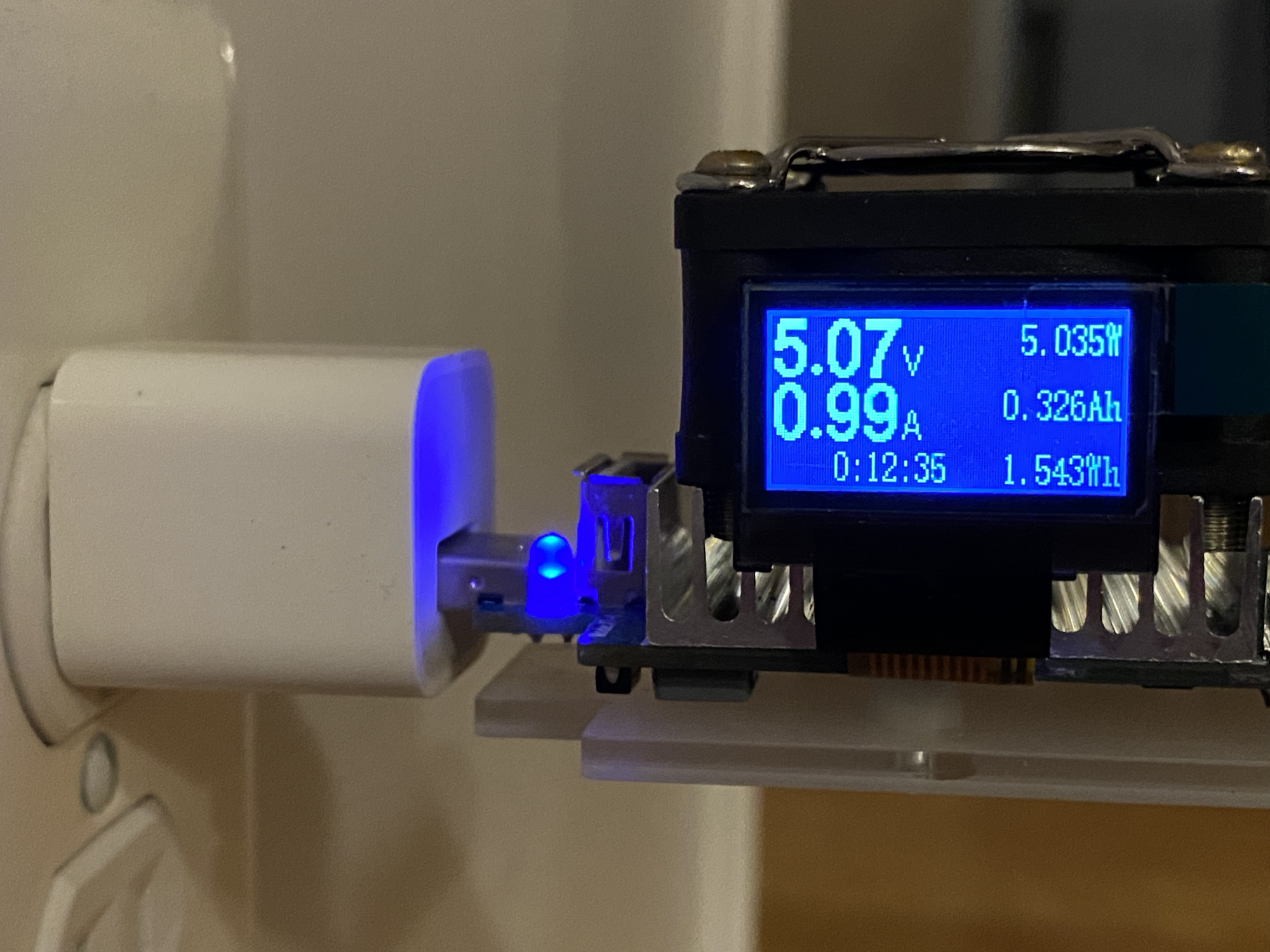

Simulated load tester plugged directly into the Apple charger and adjusted to 5 watt (upper right).
Just added a brand new Apple Lightning cable to the mix and its 4.77 watt which is a 5% loss due to the cable.
And keep in mind thats best case with an Apple 5watt charger and lightning cable taken directly out of the box it came in. I wouldn't even bother with 5 watt wireless (is that even a thing?).
Question I have for you though is were you using the phone while it was charging? It easy to make a modern iPhone use more that 5 watts. This is often seen while driving, plugged into the cigerette light or using USB 2 standard 5volt 750mV while using GPS and Music and talking on the phone via BT, etc.

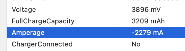

Funnily enough I just posted this in another thread. While running Geekbench 5 my iPhone was consuming 8.878watts (2.279amps x 3.896volt).
If I was charging with 5 watts or less it would be draining faster than charging thus losing percentage.
Point is I doubt there is anything wrong with your phone except possibly a dirty lightning port.
