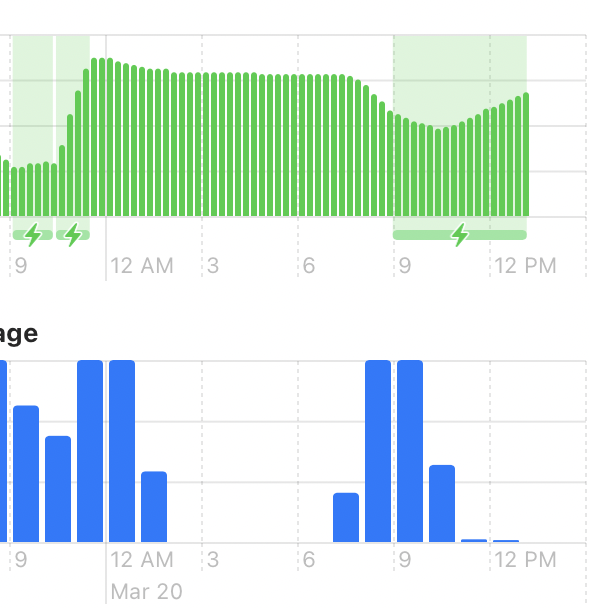

Has anyone successfully charged their M1 MacBook Air using a 5V 2.4A charger? or even just kept it alive?
I know I can buy a power bank specifically designed to follow the USB-C power spec but I wanted to ask if anyone's been able to keep their M1 MBA powered or just at the same charge level using the older 5V 2.4A chargers/power banks
I plugged mine in this morning and I was able to use the MBA for 45-50mins while it drained from 10% to 5%. Coconut Battery displayed a charge speed of 4.53W but the battery icon in the menu bar said "Plugged in: not charging"

answering my own question here, they are more than sufficient to keep the MBA alive/discharging very slowly during use.
They will also charge the MBA at 5W if it isn't in use.

I just happen to have one of the older power banks laying around, I can use it to extend the battery life of my MacBook to 24-36 hours. you can see in the screenshot the power bank lowered discharge rate to ~ 50% when it was plugged in. More than worth it on a long flight if its the only power source you have.
