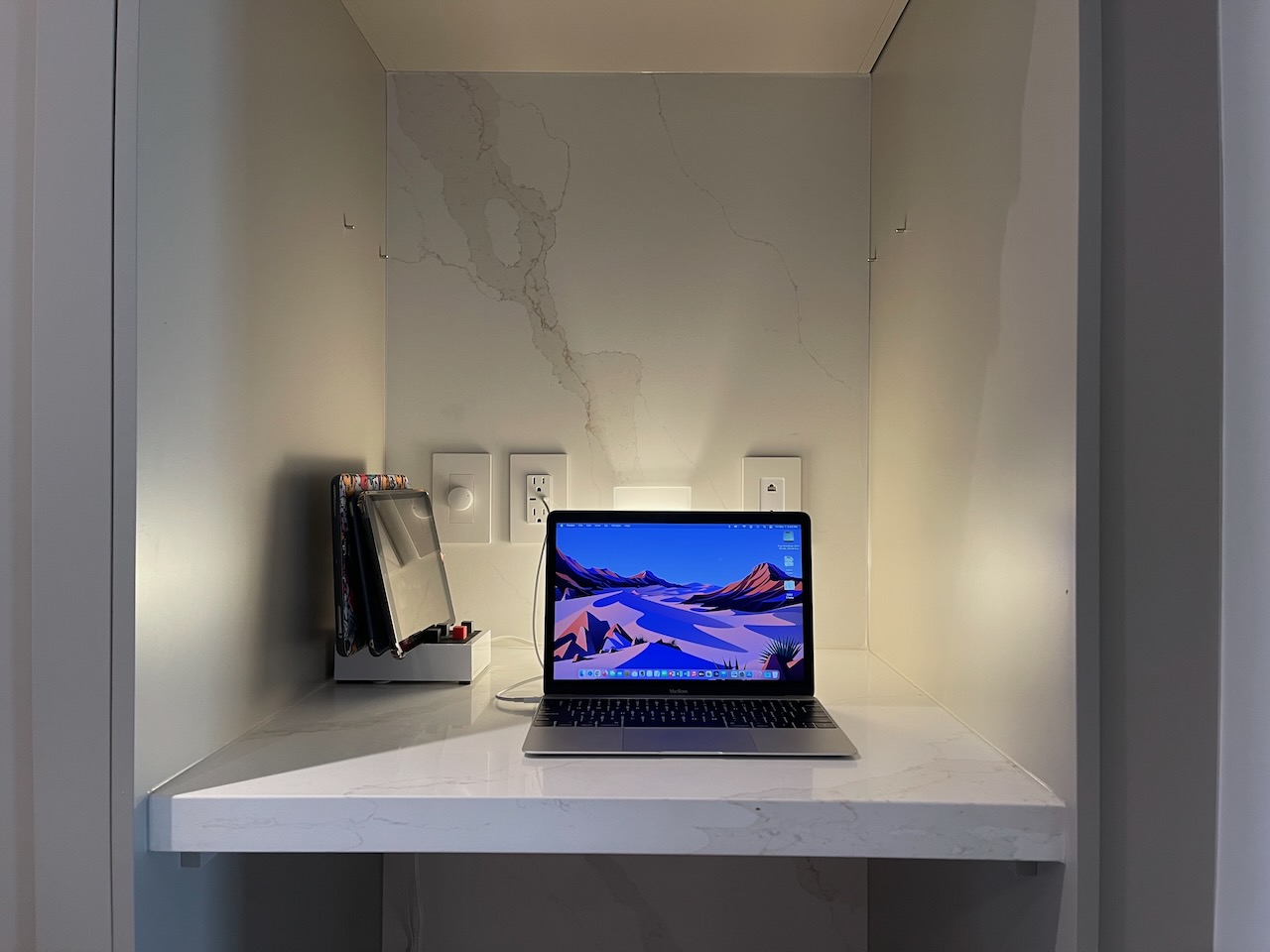

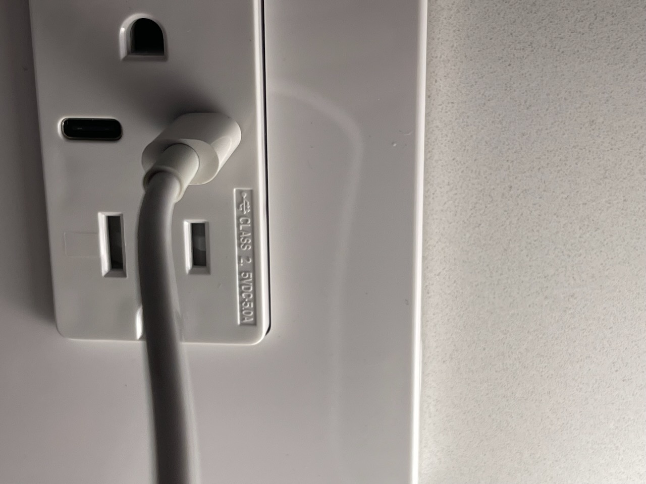

We built a new kitchen, and part of the renovation included a little nook for a computer and iPads, etc. I specified that the electrical receptacle support USB-C x 2, but the brand (Eaton) that my electrician wanted to use does not support Power Delivery. So, it maxes out at 15 Watts, at 5 volts 3 amps for a single port.
When I plug a single iPhone 12 Pro Max into it, it charges at around 10-12 Watts. And iPad 9 charges at a little over 12 Watts. A 2017 MacBook charges at a little over 14 Watts. As mentioned, the only voltage supported is 5 V.

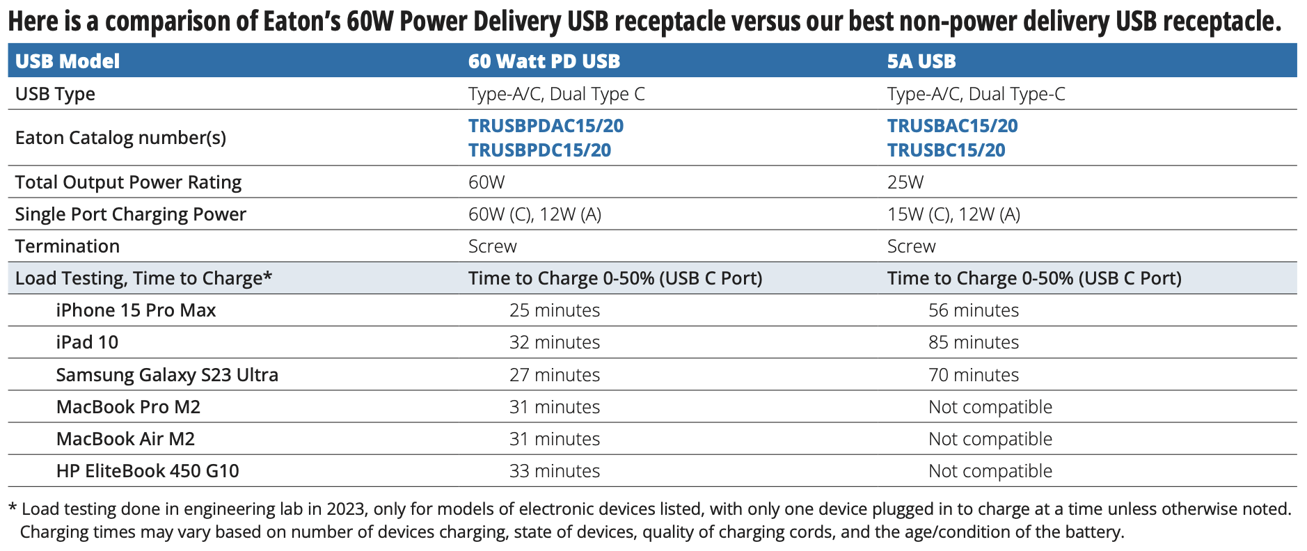

Eaton is now selling Power Delivery USB-C outlets. It says that their non-PD outlet is not compatible with the M2 MacBook Air. See my post below for details:

That 15 W (5 V x 3 A) Eaton USB-C outlet can maintain the charge on my 12" MacBook for the most part, but during usage it won't increase charge. A 30 Watt Leviton USB-C outlet with Power Delivery works much, much better.

BTW, back when I was looking at these USB-C outlets, none of the Eaton ones supported Power Delivery. The Leviton ones did, but the 60 W version was not compatible with the Apple HomePod. My electrician preferred Eaton, so we got the non-PD Eaton TRUSBC15. However, he was unable to source the Eaton TRUSBC20 for our 20 A kitchen circuits so we switched to the Leviton T5835 30 W Power Delivery model, and these are better for MacBooks.
I've also noticed that now Eaton has just released PD models this year, which start (and end) at 60 W. None of my local retailers and electrical supply store actually carry them, but I called Eaton and they said they have limited stock of it now so they can now be ordered through some electrical supply stores. I don't actually need one right now, but I'm tempted to pick up a TRUSBPDC (dual USB-C) for testing.
Interestingly they specifically indicate in their brochure the non-PD 15 W (5 V 3 A) version is not compatible with the M2 MacBook Air. I suspect it is indeed compatible, but just way, way too slow.

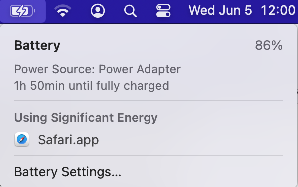

It depends on what I'm doing though. If I'm just surfing MacNN and occasionally looking at Photos, it will charge at approx. 1% every 5 mins or so.
