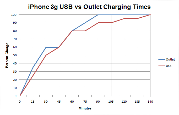

I just did a test of USB vs outlet charging and going from 0% to 100% charge took about 50 mins longer using the USB. Took about 90 mins for outlet and 140 for USB.
