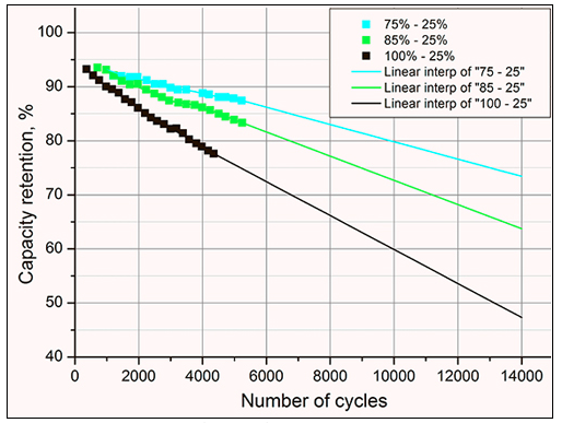

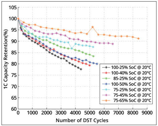

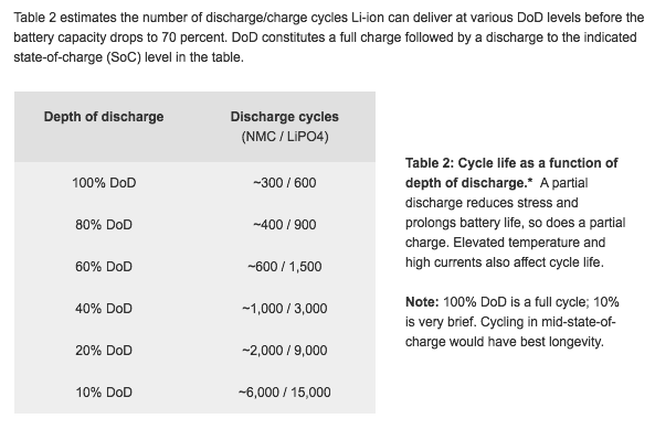

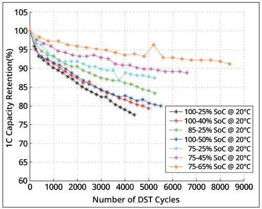

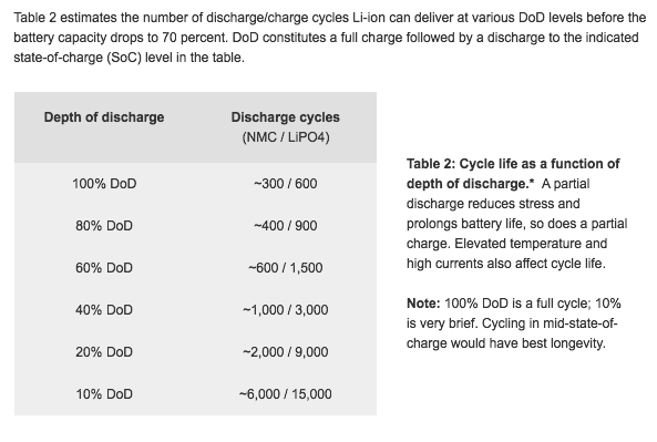

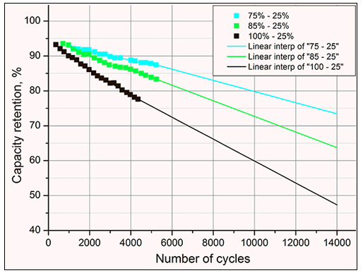

While NOT worth the effort of worrying about (except in cars) a cycle is different depending of the discharge and charge rate.
From the 'Bible'
http://batteryuniversity.com/learn/article/how_to_prolong_lithium_based_batteries
Battery University said:
...Figure 6 illustrates dynamic stress tests (DST) reflecting capacity loss when cycling Li-ion at various charge and discharge bandwidths. The largest capacity loss occurs when discharging a fully charged Li-ion to 25 percent SoC (black); the loss would be higher if fully discharged. Cycling between 85 and 25 percent (green) provides a longer service life than charging to 100 percent and discharging to 50 percent (dark blue). The smallest capacity loss is attained by charging Li-ion to 75 percent and discharging to 65 percent. This, however, does not fully utilize the battery. High voltages and exposure to elevated temperature is said to degrade the battery quicker than cycling under normal condition....
