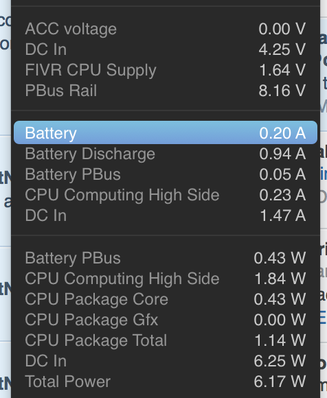

Finally got my MacBook, so I thought I'd share the results of my first charging/powering experiment.
I used my old battery pack, Anker 2nd Gen Astro2 9600mAh 2-Port 3A Portable Charger, along with the Monoprice USB-C to USB-A adapter and this USB-A to USB3-A cable. Here are the numbers from iStat. *During* mild use (web browsing, etc) it charged the MacBook battery about 1% every 30 minutes, which I consider fantastic. Given the capacity of the external battery I suspect that it could easily more than double the total battery life of the MacBook.
Surely at some point probably not too far off, there will be Anker batteries expressly made to charge the MacBook, but until then it looks like the currently available ones are quite up to the task.

This is pretty cool! I wouldn't have imagined that the MacBook could charge from a 5V device. One of the reasons for moving to USB type-C for charging is that USB type-C connectors have variable voltage available. The charger for the MacBook doesn't use USB-standard 5V, it uses higher voltage (14.5 Volts,) so it can get away with lower Amperage and still provide fast charging.
Thus, I'm surprised it is able to charge at all from USB-standard 5V. Great to hear! Even if it won't be able to charge *FAST*, as long as it can maintain a "steady state" charge while the computer is idle, you should be able to use a standard tablet-level 10W charger.

Thanks for letting us know! My rMB arrives on Wed so I'll be able to test too. I've got an Anker battery waiting for it as well, 10,000mAh/3A. All I'm hoping it will do is stop it from losing any more battery during use so I can continue using it for a while (including medium use of InDesign, Photoshop etc., and I usually have the brightness practically at full), I don't really need it to 'charge' the battery - do you think it'll be up to the task?
Running a heavier work load would I think run at a deficit even with the external battery. As you can see with my numbers, running a light workload you use about 6W total and get 6.25W coming in. However, crank the brightness past 50% and start running a lot of gaussian blurs, and you'll be well over 6W of use. That said, if you just start using your external battery while the internal is mostly full, you'll get the benefit of all the power in both batteries with continuous usage before they both are drained.
