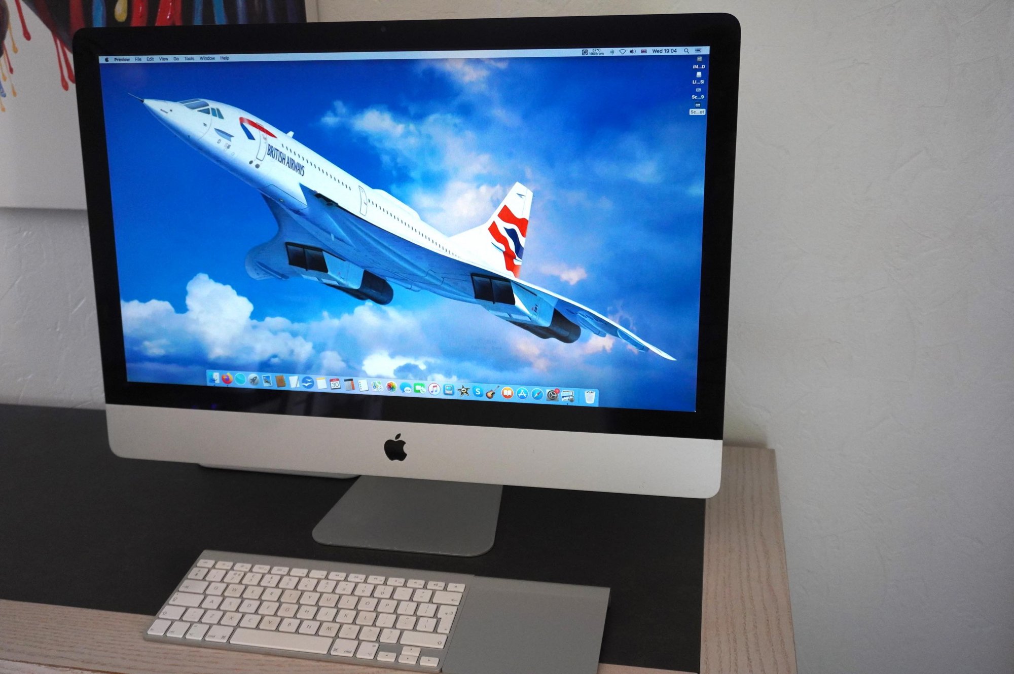

HERE's a link to my second attempt at reviving a defective GPU, and so far this 2009 iMac 27" has been functioning flawlessly for the last 6 months - web browsing is very rapid, and performs adequately for photo editing and other tasks I require, but obviously these tasks have been aided by the SSD I installed.
The 1st baking fix attempt I referred to in the link and which lasted 8months, may have died prematurely because the owner had de-installed Macs Fan Control and reverted to 2560x1440 screen resolution. (I minor correction to that linked post is that High Sierra was installed and not Mojave).
I'll also eventually provide an update to this to advise of continued serviceability or otherwise.

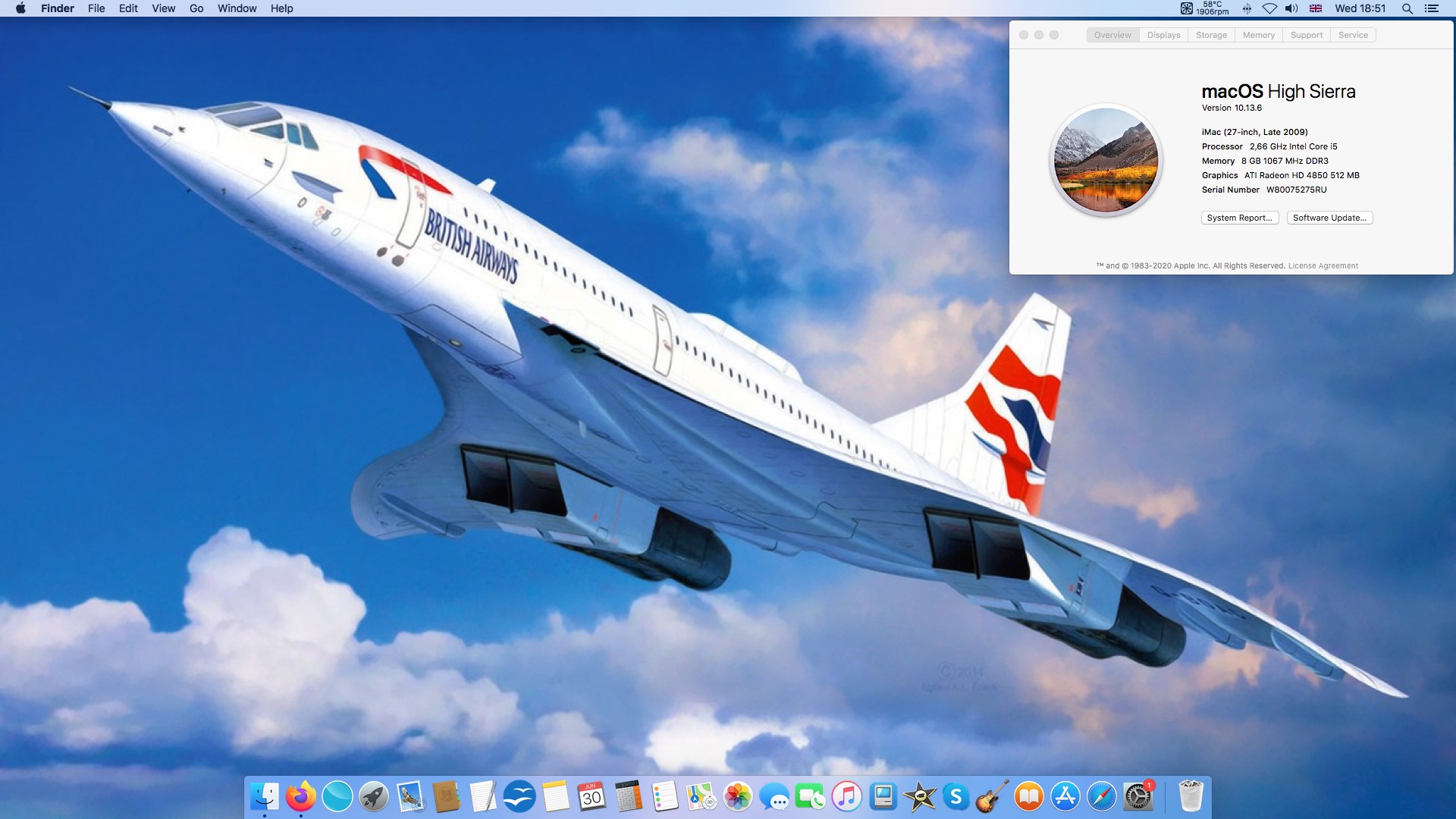

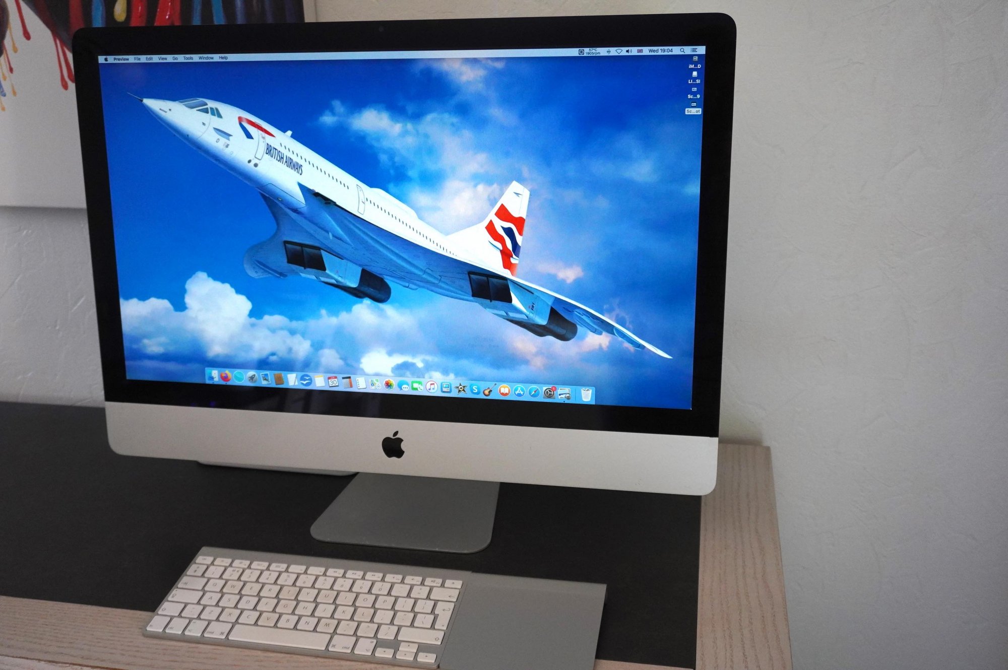

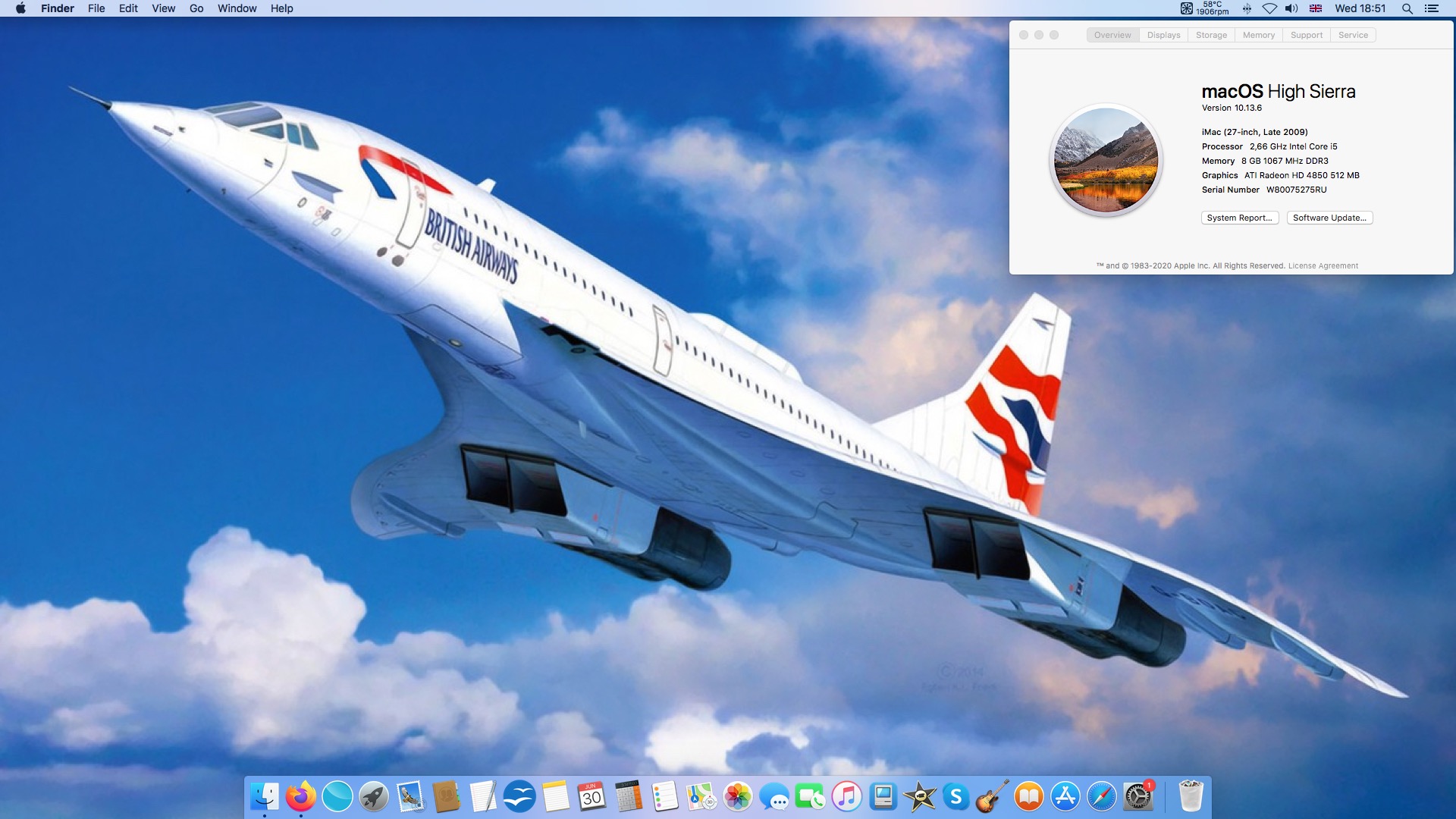

Purchased as a non-functioning unit, this iMac was very cheap. Two photos follow of this same iMac now performing admirably!
View attachment 1800073View attachment 1800078
As this iMac will be flipped with 3 months warranty I didn't bother to fully tear down the gpu, i just removed the gpu from the logic board and put heat on the backside of the card in the area of the Xbracket 420' for 5 minutes. Cleaned all the dust out and reassembled.
Buyers will be informed that the gpu will eventually need to be replaced and I'm happy to provide this service if the buyer requests.
Temps look good. 👍
Something interesting, this iMac with the Kingston SSD doesn't require a fan controller app, the HDD fan is not loud and spinning at 1100rpm when temps are normal.

High Sierra, and yes it displays in Mac fans control the temp.

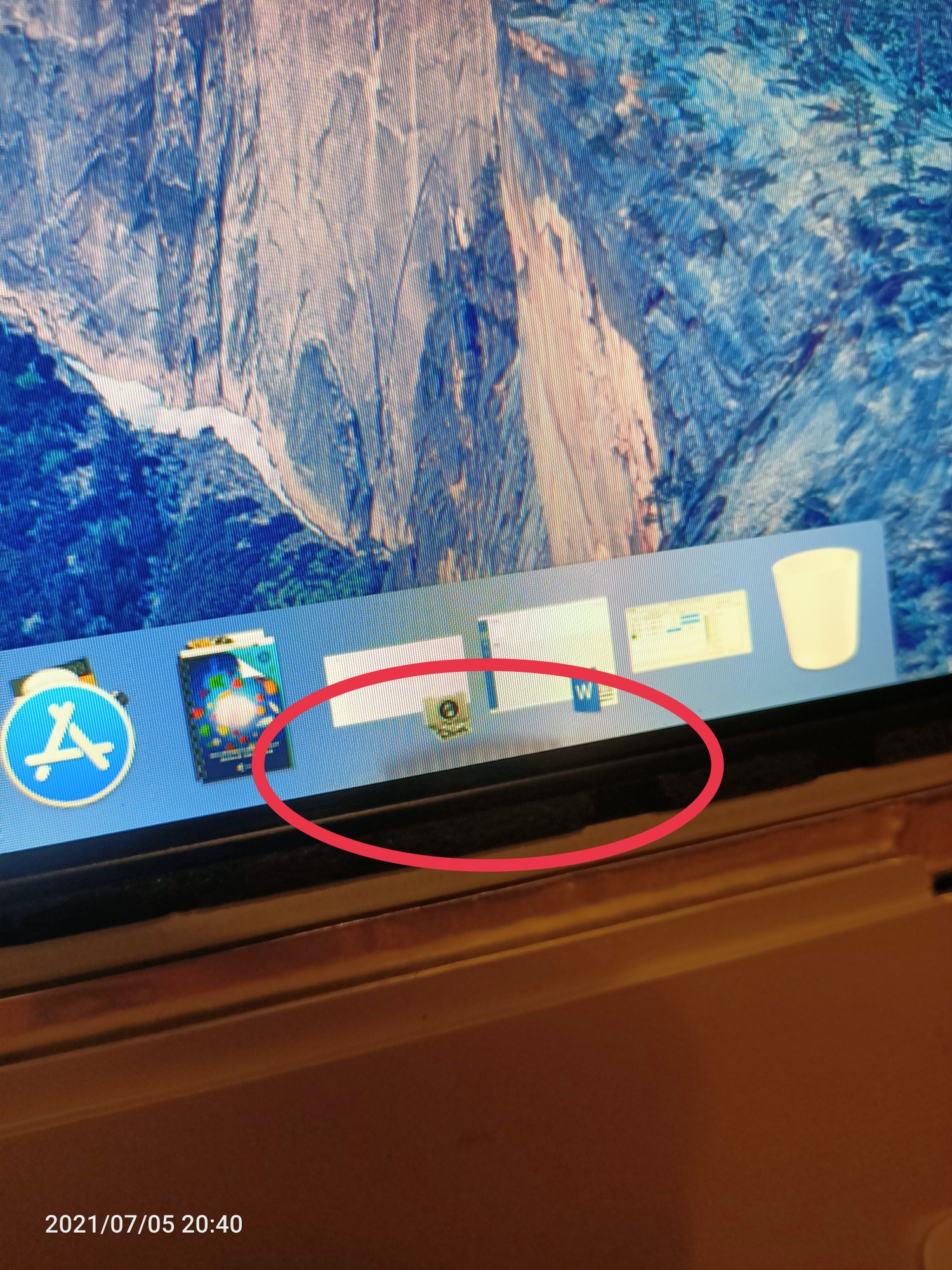

About to open my mums imac and finally fix the burn mark shown in the pic.

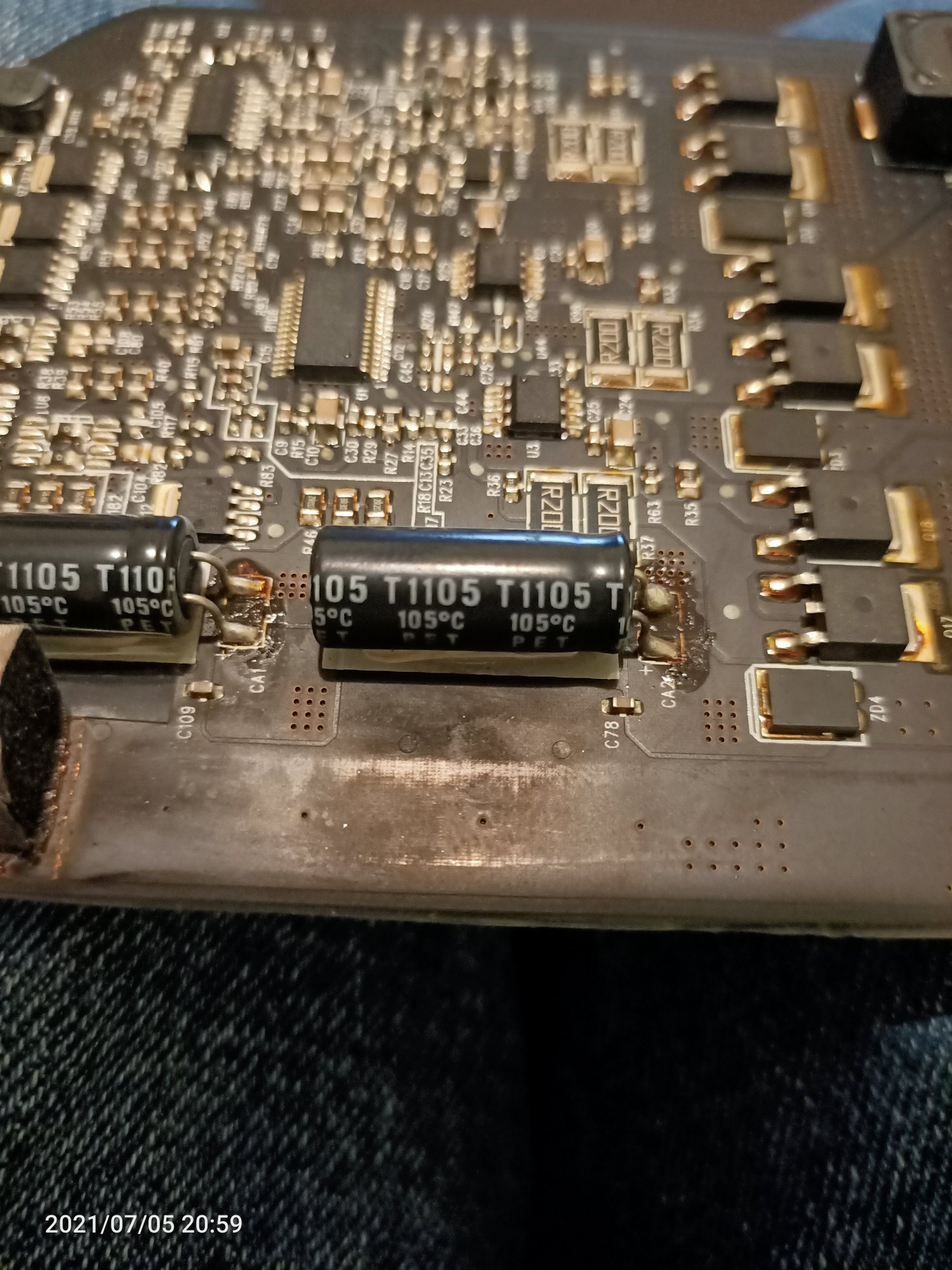

Anyways perhaps someone can help me source a backlight power board cap, mums mac also would randomly shutdown the backlight, I swapped the board and have been blasting YouTube on full brightness for 4 hours now and no black screen, closely looking at the board I think one of the T1105 105 deg c P E T caps is slightly bulged. I want to replace the cap, a quick google can find them but not rated to 105c degrees?
And I swear im not tripping but i was sure I saw burn residue near the cap on the edge of the board but i rubbed it and there didn't seem to be much and now disappeared, and look at that fat ass funky solder joint.....

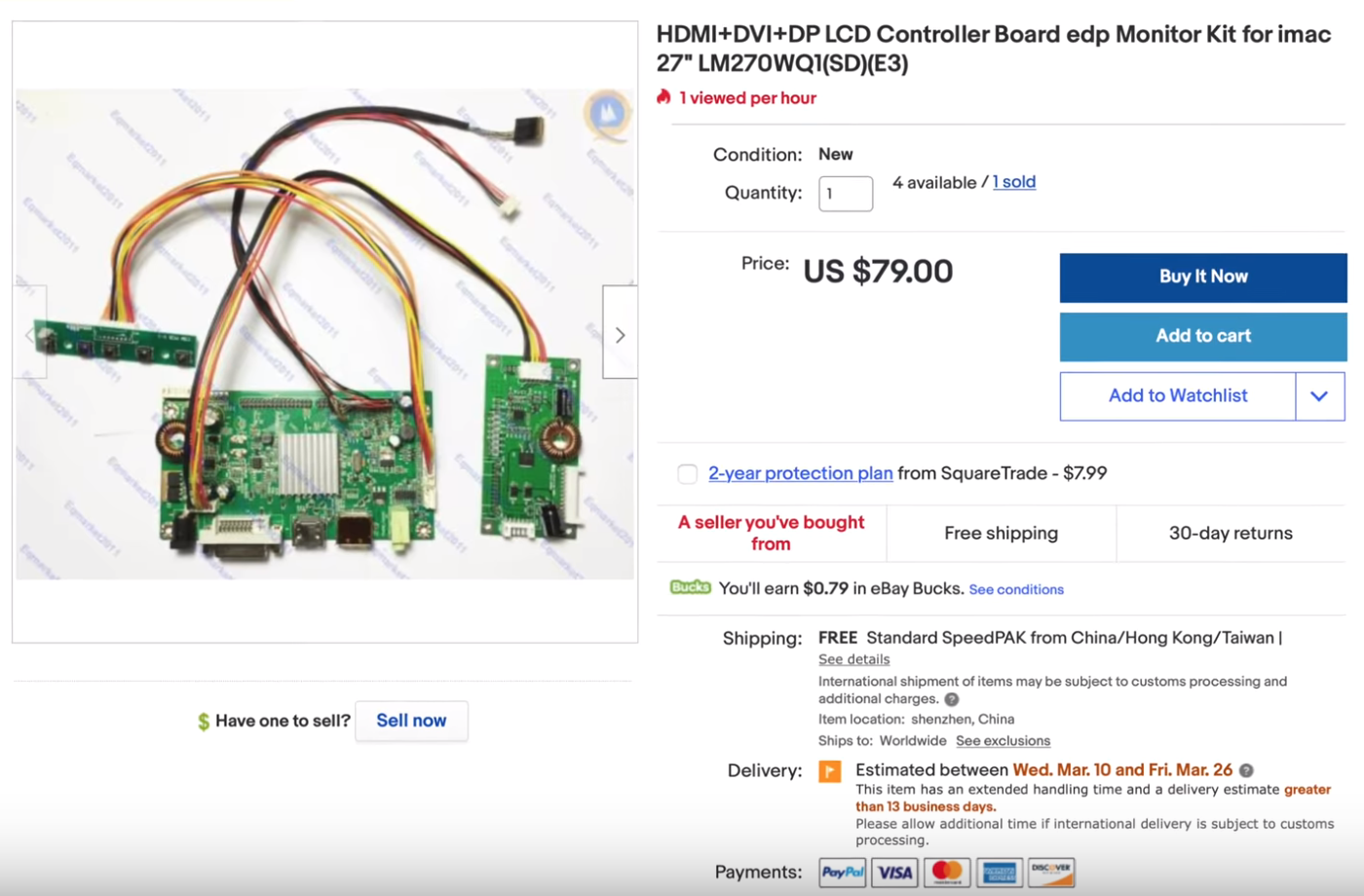

At $70 you could get an HDMI adapter and have a really inexpensive QHD monitor too.
You cannot use a 2011 iMac as a monitor via HDMI or Displayport (unless you totally gut it so it's just a monitor). Target Display Mode only works via Thunderbolt on these and the other machine also needs to be running macOS FWIW.
Yeah, that allows driving the iMac's LCD from external sources. But the iMac will no longer function as a stand-alone computer then, will it?
