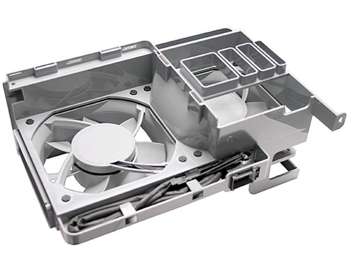

After 5 years, my front fan assembly started making crappy noises last night.
I bought this thing in 2006, and needless to say, it is out of warranty. I found an $80 replacement online and I can't bring myself to pay 5 times what these things are worth. I'm willing to drill out the fans and replace them.
My question is: Has anyone tried to swap these out? I heard they are two 120MM fans.
I want to use the existing on-board power source. Is that a problem? Will the computer fault for the change in current?
Any help or tips would be greatly appreciated.

I don't know if it still applies to Macs of your vintage, but I know the current ones cannot use "normal" PWM fans since they use a proprietary speed control on the 4th wire.
Attempting to clean out the fan bearings may be a good first attempt to avoid the necessity of replacement - at least you will be not much worse off.
I was going to say...... those fans look like standard 80mm units, but I did forget they were 4pin. Otherwise, you could swap any other fan right in and call it a day.
The Apple supplied fans are quite good though, you'd have to spend a little to get a fan as good as the OEM... and then it still wouldn't match the color 😛

They're just 120mm standard PC fans..yes apple has a special PWM but modern fans don't spin all that fast and move more air..best of all they're quieter than stock.
