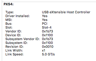

I can 100% confirm that the KT4004 works in macOS 10.13.4 on authentic MacPro5,1. Also works on many other machines. Check that forum post for additional info.
