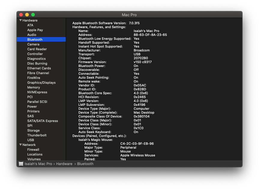

So I've got a fully up to date Mac Pro 3,1 running DosDues1's Catalina OS. I've been wanting to upgrade my WIFI/Bluetooth card and have ordered one of the mac cards with the adapter. The problem is when installed the Mac would not boot. So dealing with hackintoshes I have used the Fenvi FV T-919 with good results. This card allows you to be able to unlock with your apple watch handoff, and continuity. Comes with Bluetooth 4.0 and 802.11ac all for $59.99 fully compatible OOB. So I ordered one for the Mac Pro the problem is you need a USB Header plug which the Mac Pro does not have. BUT you can order a CRJ 9-Pin USB IDC Dupont Male Header to Single USB 2.0 Type A Male Cable which plugs on to the cable on the Fenvi card needed for Bluetooth and you just plug it into a USB plug on the back of the machine. It works great and for a total of less $70.00 it's a cheap upgrade that takes 15mins to install. Here are the links to the parts you need:

And this allows Handoff/Continuity and Unlock with Apple Watch on Catalina?
Yes sir with no added kexts. I did have to turn off wifi and bluetooth on my iphone and the Mac Pro then back on to get hand off to work. After that working 100%.

Are you used by the Fenvi card? I had to turn off WiFi and Bluetooth on both my iPhone and my Mac Pro. After I turned them back on it all started working. If your using the stock WiFi Bluetooth card it’s not compatible with hand off.

Strange it says handoff capability yes. Like I said earlier I shut off WiFi and Bluetooth on Mac and iPhone then turned them on it worked perfect. And you connected to the same WiFi 5mhz or 2.4mhz

Ok I just checked mine again and handoff was not working. I had to reconnect my iPhone to the Mac Pro through Bluetooth then it started working. Pair your iPhone with your Mac see if that fixes it.

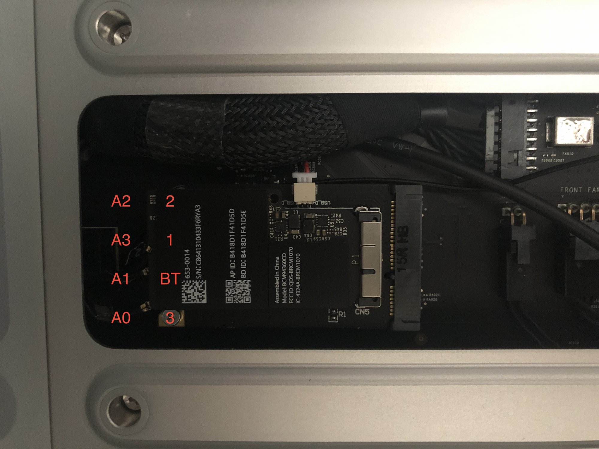

Thanks for this post... has been really helpful. I have the same card and am having issues based off which slot I instal it in. Works fine on slot 3, but the Wi-Fi doesn’t work when installed in slot 1 or 2. Any thoughts? I have a 5.1 tower.
Mine is a 3,1 and installed in the top PCIe slot not sure of what number. WiFi should work on any slot I've had mine in the bottom PCIe slot also. What won't work is bluetooth unless you have the cable plugged in to a USB port. Make sure the factory WiFi card if you have one is not installed.
