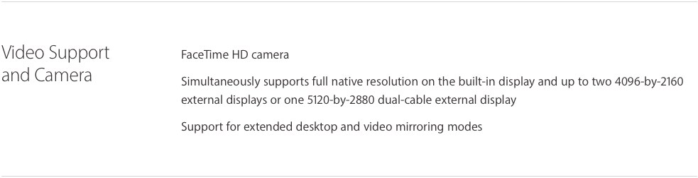

What? The 5k iMac can support an ADDITIONAL two HiDPi displays? Or did you mean to say that it can support one external HiDPi display and since the 5k iMac is well, HiDPi, that is two displays. Just asking for clarification. And I assume any extra monitors would require an upgraded GPU?
Very clearly state on the Apple's webpage. No GPU upgrade required as long as you are choosing the 27" 5K iMac.
I've seen Apple's statements before about graphics issues and they seem to grossly inflate its abilities. Most tech companies does this, I am not picking on Apple.Maybe it is possible to push two external 5k screens on them but I doubt it will be functional in real world use.
And a quick youtube search shows no one who has this setup; certainly if it worked, you'd be able to find at least one video showing it off: https://www.youtube.com/results?search_query=imac+5k+dual+4k+monitors&page=&utm_source=opensearch
This is a kind of extreme setup, not necessary able to find video on YouTube. If you search from Google, you will see few reports on other forums that said they can drive 2x extrenal 27" Dell 4K display with the 27" 5K iMac (4G VRAM GPU), however, no prove, pictures, or videos.
