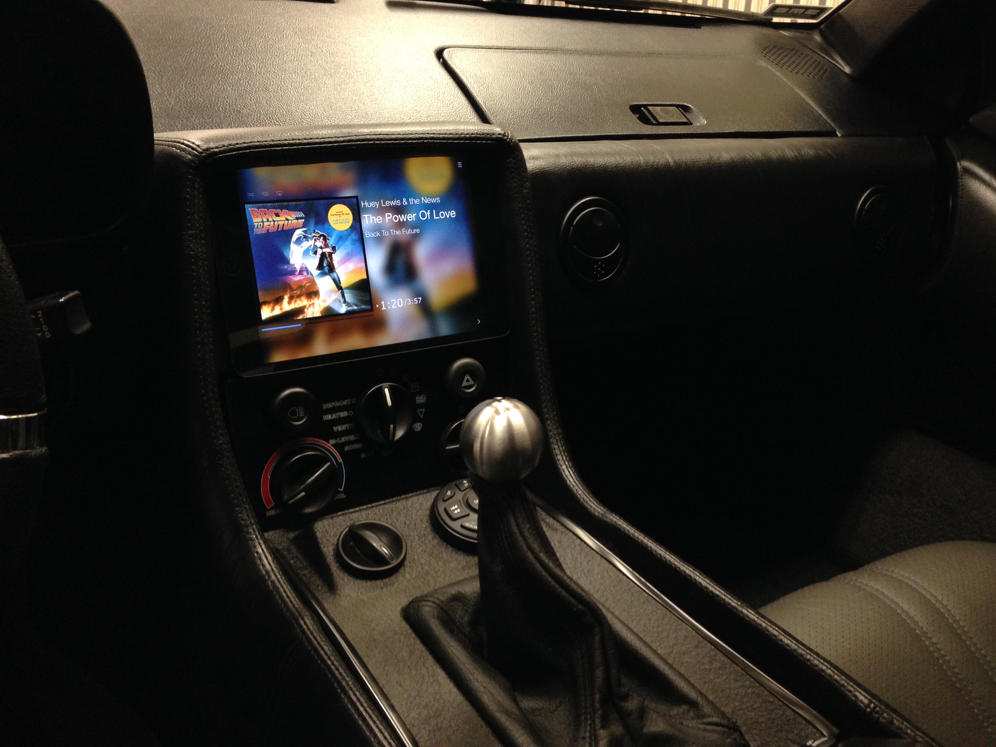

Yes. I have a dash/console integrated iPad Mini 2 in my 1981 DeLorean. It is connected via lightning cable to a Sony headunit installed in a cubby behind the seat. By using Sony's AppRemote app, I can control all stereo functions from the iPad itself. With the iPad being jailbroken, I can enable even more functionality---for example, I have Activator installed to automatically unlock the iPad when the iPad receives power (in other words, the key gets turned and the iPad gets unlocked). I also have it set to open the AppRemote software immediately after being unlocked. Little tweaks like this are nice to have and can only be obtained for me via jailbreaking.
