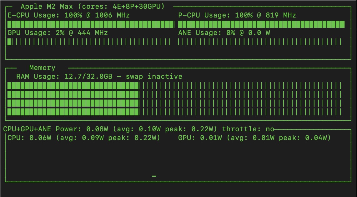

With the M-series Macs, any laptop can be run off as little as a 30W adapter. I'm sure someone has even run the MBA off the 20W USB-C adapter as well, but I wouldn't recommend going below 30W just to minimize battery stress. If you open a Terminal and type the following into Terminal:
Code:
 sudo powermetrics
You can check what the power draw is for the system as a whole, in addition to specifically by the CPU and GPU cores. I use a tool called asitop to present that information in a graphical format.
Keeping either version of that tool running can give you an idea of what your peak power draw actually is, so you could better pick a smaller/alternate charger for your Mac.
