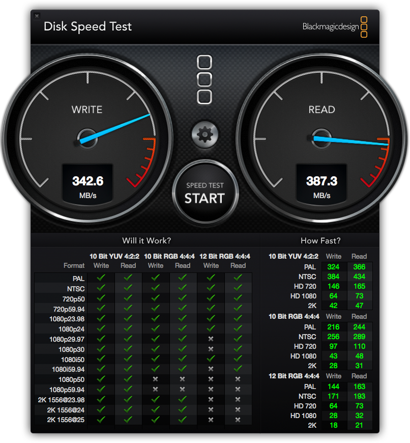

I don't have a Lacie, but I do have the 500GB 840 EVO in a Delock Thunderbolt enclosure and I suspect you would see very similar performance from either. I've been using this setup for 2 months with no issues whatsoever.
Perhaps someone with the Lacie can post a BlackMagic Speed test. Here's mine:
The drive will be staying next to my iMac (not worried about portability).
In that case, another advantage of the Delock is that it runs on AC power, as opposed to the bus-powered Lacie.

I have a retail LaCie "Rugged" 500GB SSD and it contains a Samsung 840 EVO 500GB SSD. It has both Thunderbolt and USB 3.0 interfaces and comes with cables for both. It is bus powered and is running fine for me so far. You can easily slip off the orange bumper if you want to stick it on the iMac stand with velcro strips/dots.
It also will boot Windows externally on a Mac (not all enclosures do this).
The line powered Delock enclosure mentioned above also looks pretty good if you want to DIY.
As you might expect, the test results are similar.
