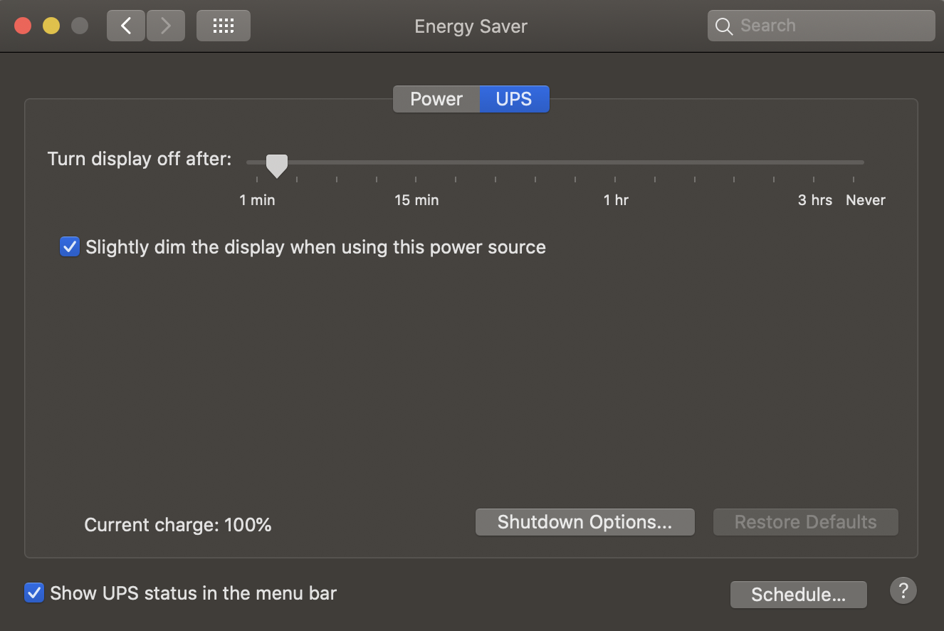

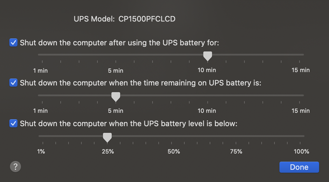

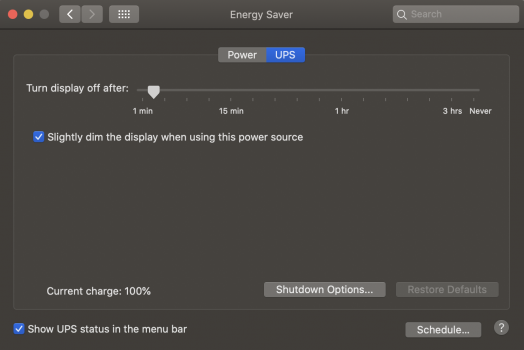

I don't understand the purpose of USB connection... You're still plugging the Mac into the AC outlets on the back of the UPS, as expected? Does USB give additional options?
Most UPS units have a USB cable that communicates with the machine (Mac Pro) and interfaces with the OS in the Energy Saver Preferences Panel that enables shutdown triggers, etc. Here's Cyberpower unit connected to an iMac19,1.
