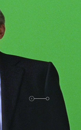

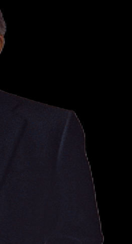

I chroma keyed a video using Motion's Primatte RT filter. The green was removed, but there are (white?) jagged edges around the subject. I have attached two screen grabs so that you can help me:

Shake also has a Primatte filter (although its more advanced one is keylight's). You should be able to get a good result with Primatte in Motion, perhaps tweaking the falloff/softness of the mask would help some.

I used the Matte Magic filter in Motion 3 (thanks to Ripple Training) and adjusted the Shrink and Feather settings. That resolved the white around the jagged edges. It looks better, but I worry that the edges are not perfectly smooth yet. So I'll try your suggestion as well as a tutorial on Lynda.com for Shake.

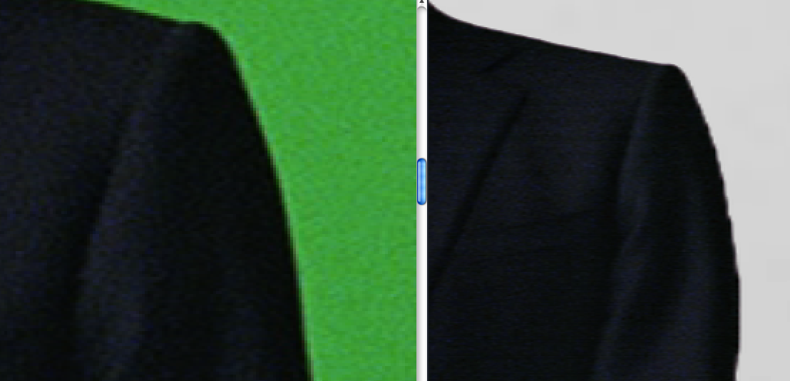

Here's my latest issue -- lumpy edges. I found a way to get rid of the green around th edges, and the key actually looks fantastic compared to what I did earlier. But now I'm concerned about this slightly rough edge (right). The original looks very sharp (left), and I want to emulate that:
Actually, the edge on the left appears softer to me than the edge on the right, which I think is why the one on the right looks unnatural. Have you tried feathering the edge? Just use a tiny little bit of it, you don't want it to be too soft. Other than that, don't expect perfection with DV/HDV footage.
