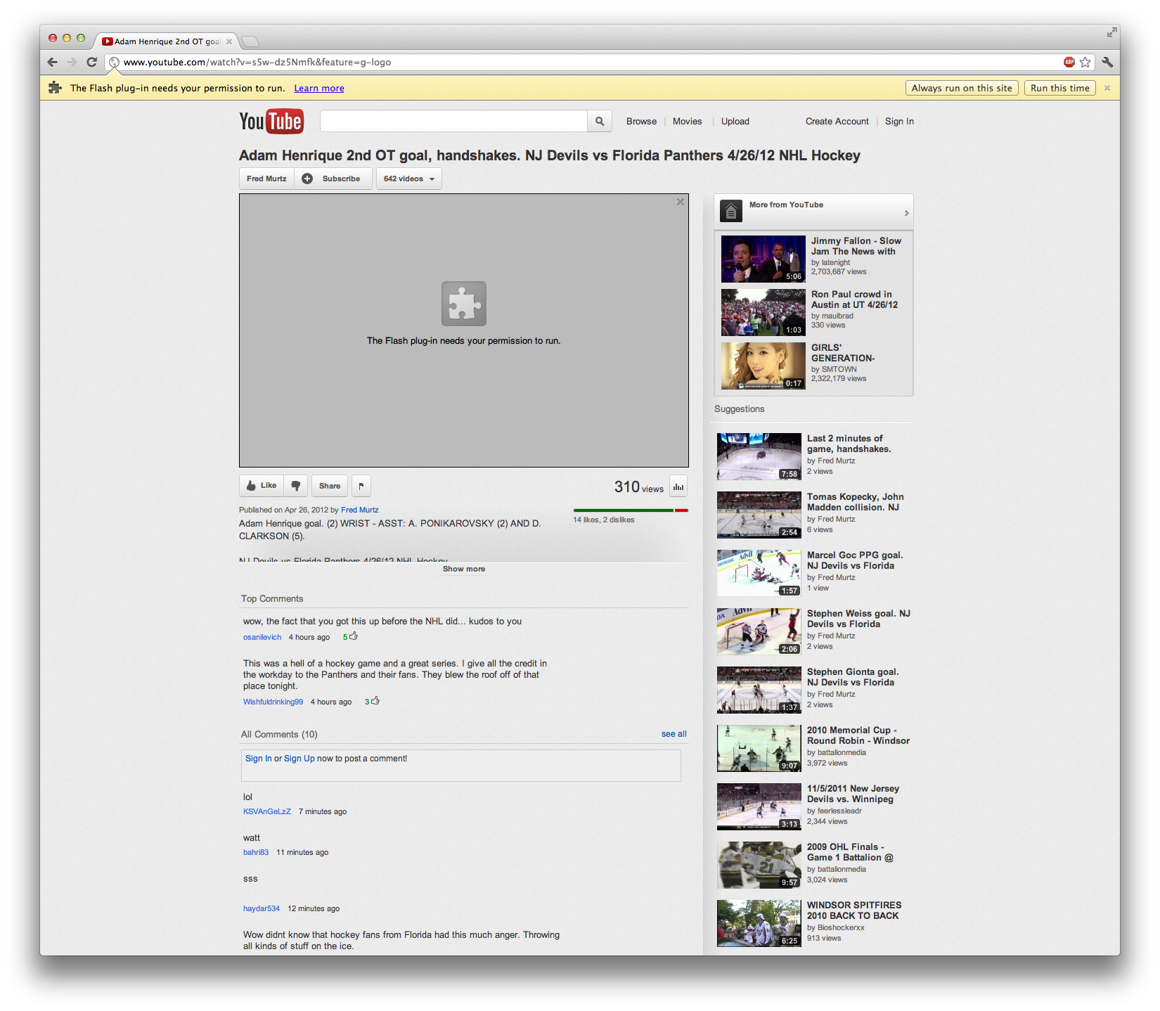

I've been having this issue for a while on my Mac Pro and I've tried everything.
Anyone have any ideas?

Chrome uses its own Flash plugin (separate from anything you've installed for Safari) which is supplied within the application bundle. Make sure you haven't disabled it - go to settings/under the hood/content settings and click 'disable individual plugins' Check that the flash plugin hasn't been disabled.
If it hasn't, then disable it, restart Chrome and enable it again - that should re-write the preference file accordingly.

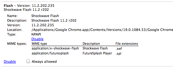

I've have no flash conflicts within the "about😛lugins" section - I've read if you had to installs it might cause conflict, but I'm fine.

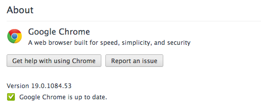

I've added a picture of the version i'm running - it all works fine on the new user profile, so what's wrong with my current profile, anyone?
