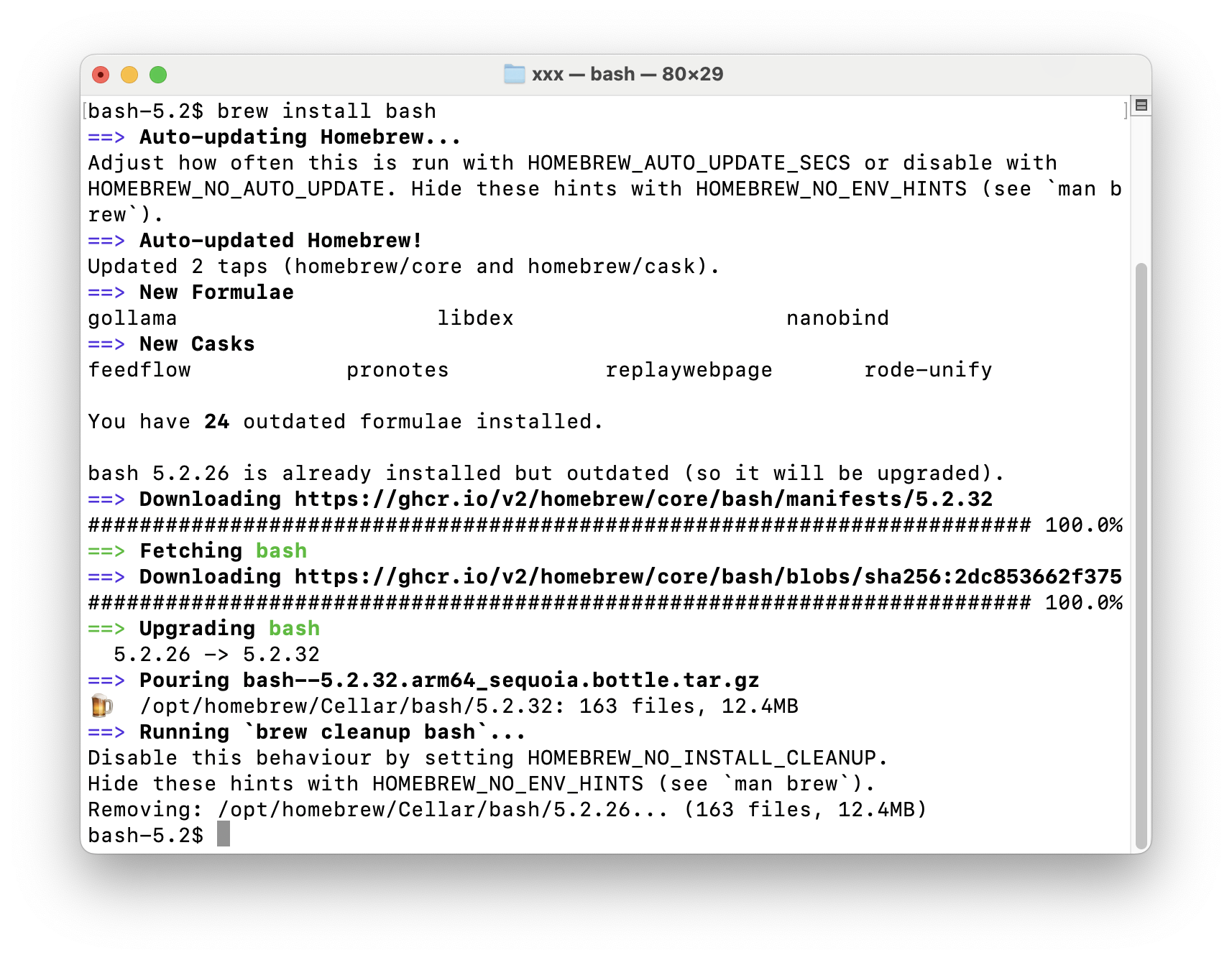

How can I see what version my bash is?
Edit: I just entered bash and it shows 5.2
Could be I installed it, when I searched for commands to install with homebrew and just installed some without knowing what they are.
echo $BASH && echo $BASH_VERSION
Tried that, but wasn't in bash and only got an empty line as output. 🙈
P.S.: I don't even know what bash is but I like having newer versions of everything.

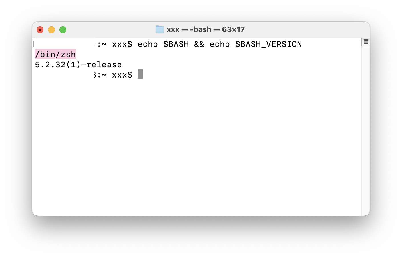

You have to use `chsh -s /opt/homebrew/bin/bash`
Thanks.
But I had to change it in the menu too, that it worked.
Why does it show zsh there?
P.S.: I changed my user name a while ago. Will it forever be xxx in Terminal and Finder?
