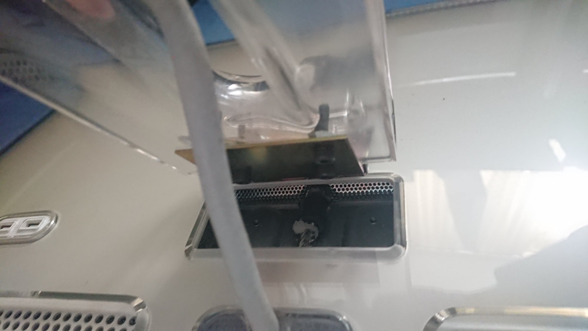

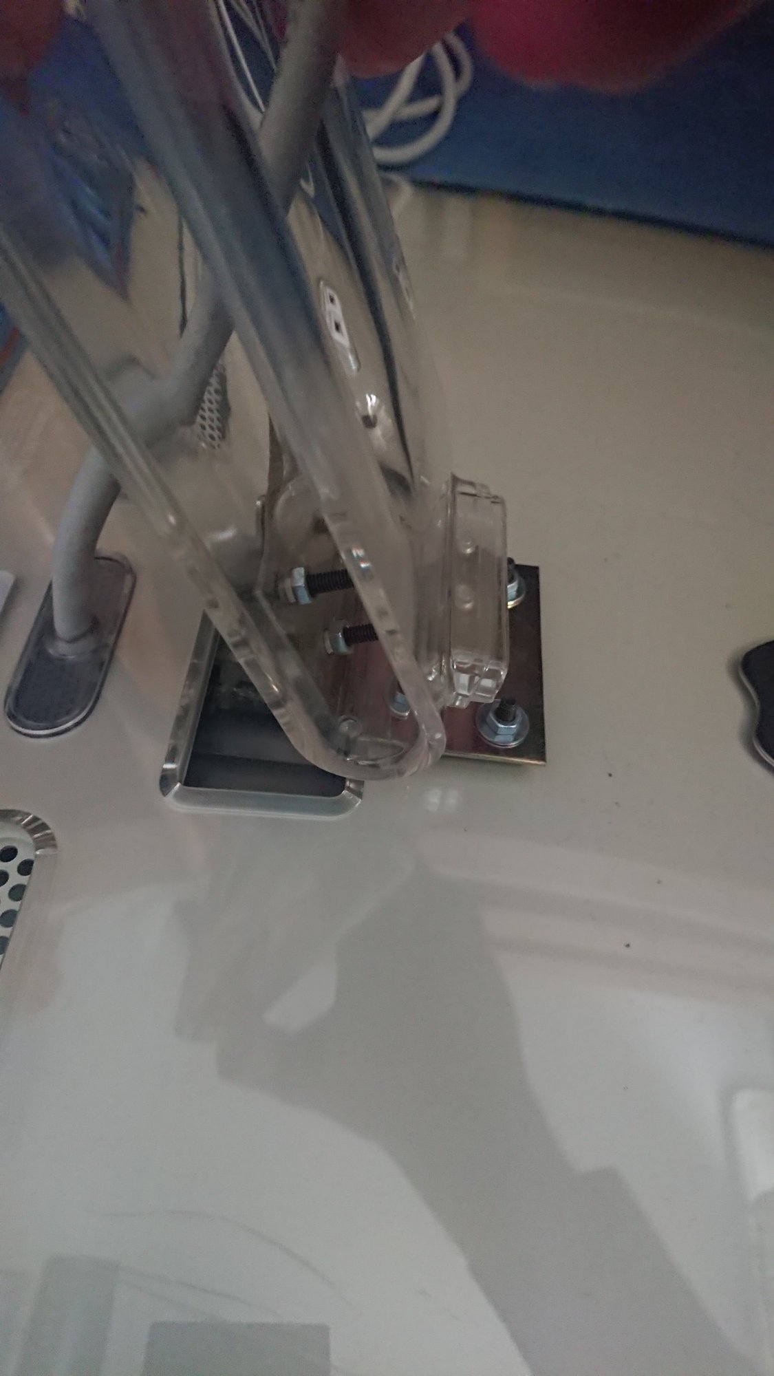

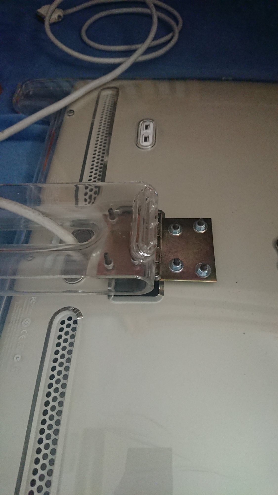

This one actually broke off on one of my ACDs during transit
Did the same with a 23" ACD taking it home from the seller when I went over a speedbump. The plastic stand was fine, the brittle hinge metal cracked. Every repair attempt flopped badly. Not even metal epoxy could withstand the shearing force the weight of the display brought onto the hinge and nothing except perhaps welding is ever going to fix it. I haven't glued the kickstand directly onto the back. Not sure how you did that but if I have time, I might see if I can get a VESA plate connected somehow. The whole kickstand mechanism is way, way too fragile to properly support the weight of the display. I don't know what the designers were smoking when they signed off on it.

Ah. It looks like you found another hinge that would fit both the arm and somehow screwed it into the polycarb back lid. I might look into finding something suitable. I could easily live without the springloaded folding mechanism as long as the screw/glue combination doesn't crack the back lid under all that weight it has to support.
