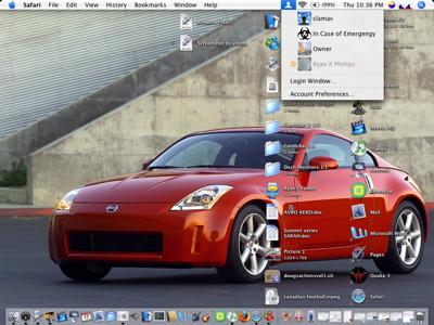

ok, so the other day i installed tiger on my 12" powerbook G4. everything went fine. i restarted. but when i came to the login screeen it showed a new account called "clamav" i disregarded it and logged into my account, then promptly checked the accounts preff pane, and it didn't show up. when i turned on the PB the next morning the account was still there. so i tried to login, ended up creating a password by entering the master. i logged in and it said that the home folder was missing or something like that. and it still didn't show up as an account in the accounts pane. it is still there in the login window and also appears in the fast user switching menu.

clamav is a newly installed user as of Tiger.

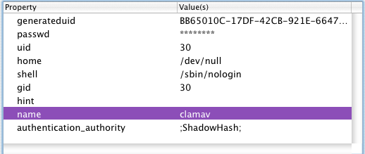

Here is the requisite info from NetInfo Manager.
You should compare your version of the clamav user with the one I listed above. If they differ, you should be wary. Did you originally create a user named clamav, or is this the one that is Apple installed?
no, this is one that just appeared after i installed tiger. heres screenshot
lemme know if this is bad.
