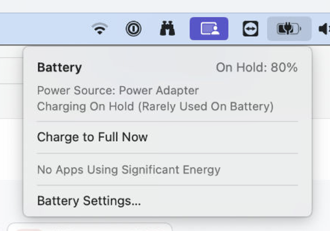

I have an older relative who keeps her MacBook Air plugged in 24/7/365. When I remote in to help her with stuff, I see the message above. The charging system will start limiting the charge to 80% if you leave it plugged in a lot. Not sure what the threshold is for that. Are you seeing this message when you’ve had it in clamshell mode for a while?
When she replaced her last MacBook after like 6 years, there were like 5 battery cycles on it, and all those were from when I’d come visit and unplug the poor thing for a few days 🤣
