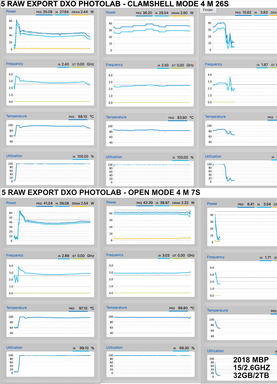

I suppose we all know by now that the 2018 MBP has problems with heat dissipation. Since I use my MBP mostly on my desk in clamshell mode running to my external monitor, I started feeling slightly reduced performance compared to when I was using it by itself so I decided to measure the difference using DXO Photolab and exporting five 42 megapixel images with PRIME noise reduction (a heavy test on the CPU, requiring roughly a full minute per file to export) to peg the CPU at full load until the export completed
Summary of results in the attached image but for my use case:
Slightly lower initial boost clock
Lower sustained clock (dropping even below base clock after a while)
Reduced wattage drawn from the CPU and consequently lower sustained temperatures in clamshell mode (maybe because the dGPU is active with an external monitor?)
An 8% increase in export times using clamshell mode
Performance above base clock is therefore not guaranteed even with the i7 2.6 with maxed CPU-only loads when in clamshell mode
I did not expect that high of a performance hit, so I thought I'd share it here. In real world use there is a small but noticable difference in snappiness and overall speed using the laptop as-is compared to in clamshell mode with an external display, particularly in high workloads
For the sake of completeness, I decided to run the same test with the screen open while connected to my external monitor. Giving it room to breathe does next to nothing: the same export finishes in 4m25s, a whole second faster than when in clamshell mode. Clocks also drop below base clock after a while, just like it did in clamshell mode.

I think it's because of thermals. I did some simple tests with my 13" and found that with the machine itself, the CPU package uses 0.5W on idle, where as in clamshell mode it uses at least 4W. This means you've got 10% of your total thermal capability into just running the display output.
I'm guessing it's because the Type-C ports don't connect directly to the GPU, they go to the CPU, which has to somehow redirect the video signal to it, causing additional power drain.
Also in Clamshell mode the top casing is insulated by the air gap between the screen and the keyboard. Where as if you open the laptop the top casing can also dissipate some heat. So for maximum performance, you actually want to run the machine open with no external monitors.
The problem could be worse on the 15" because not only does the dGPU needs to be powered up, it also doesn't have direct connection to the ports, the graphics have to be rendered on the dGPU, sent to the CPU, and then redirected to the ports.

Its funny, I'm seeing lower temps when I use it for my work related stuff (nothing demanding). I usually connect remotely to my work computer but I'm seeing temps in the 47c range in clamshell mode, and about 57c with the screen up. I was actually surprised surprised to see the temps.
Feeling the screen after being in clamshell mode reveals that its warm, not hot but warm. I'm not sure about the long term affects that will have so I'm not sure I'll keep doing it.

So actually its not clamshell mode thats causing the reduced performance, but just connecting it to an external display...
Pretty much, runnning the DGPU even on an idle desktop takes away from what little thermal headroom remains available such that the processor will throttle below base clock at full load
