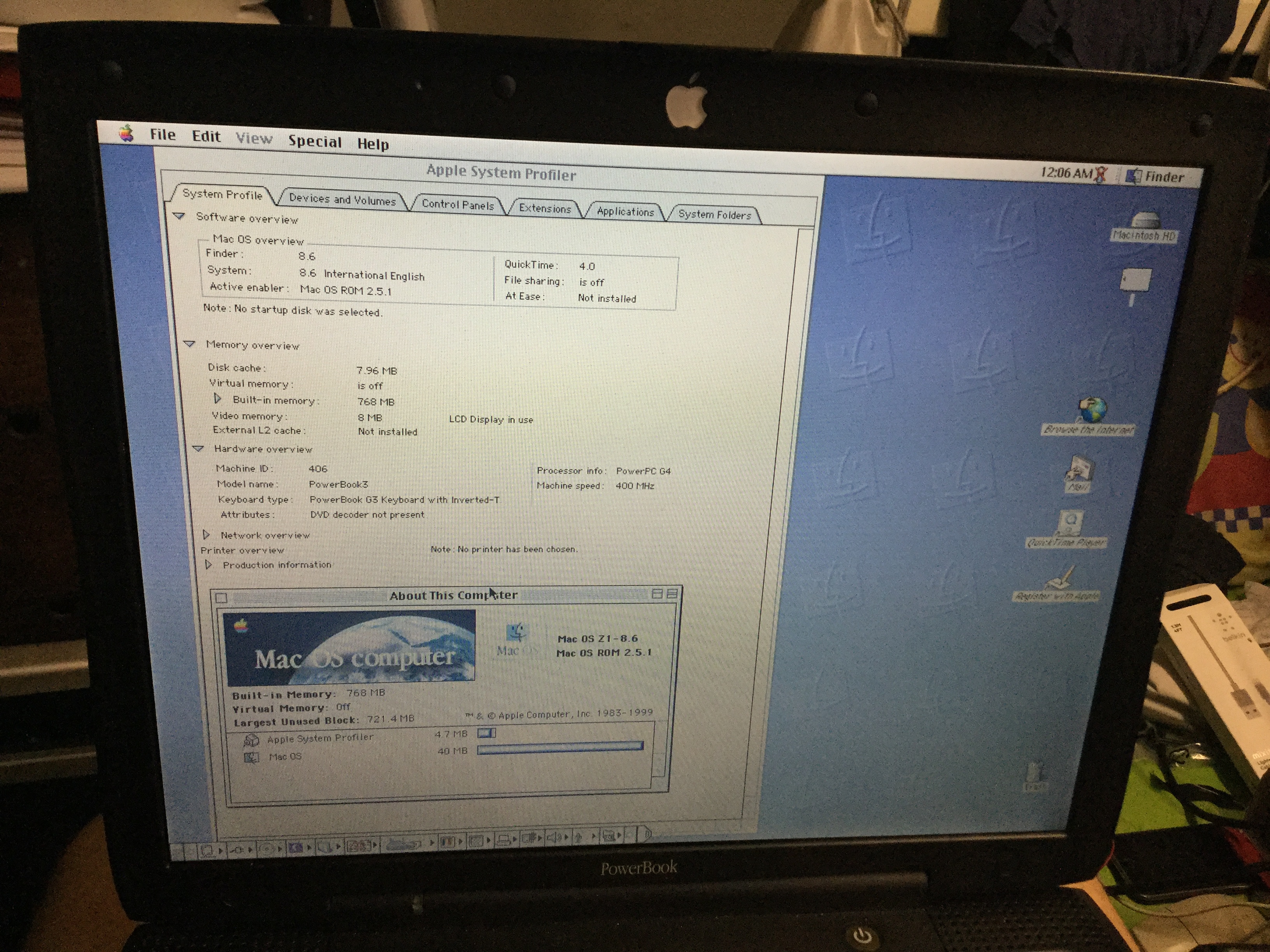

I was able to get my Pismo to boot Mac OS 8.6 using @LightBulbFun 's techniques found here:
