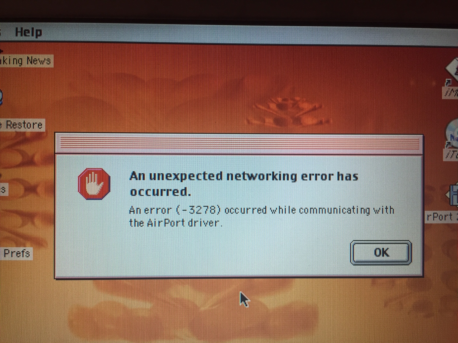

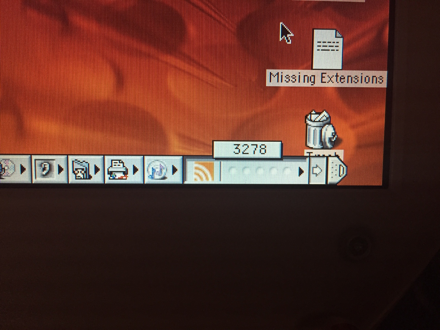

Just got my clamshell today. Its running 9.2.1 and it has an airport card installed. However, I keep getting error code 3278. It appears when I open the airport app and when I go to where there should be networks, and all I see is 3278. I've tried swapping AIrport cards, I tried reseating it, I tried a fresh install... Idk whats wrong with it, but its annoying me to no end. Any ideas?

Sadly, this did not work. I did everything as stated in the proper order. The new airport drivers were in Extension manager and were turned on. It still didn't work, so I reset PMU (which I did correctly since the time/date was reset), but that didn't work either...
That's what the error looks like, incase you were wondering. I also updated the firmware and reset PRAM and PMU, which both didn't work either...
If you select "MacOS All" in extensions manager, is it saying you've got missing extensions ?
I only ask due to the text file on your desktop with that name?
No, that's from earlier when I was removing some duplicate extensions that were preventing it from booting...
