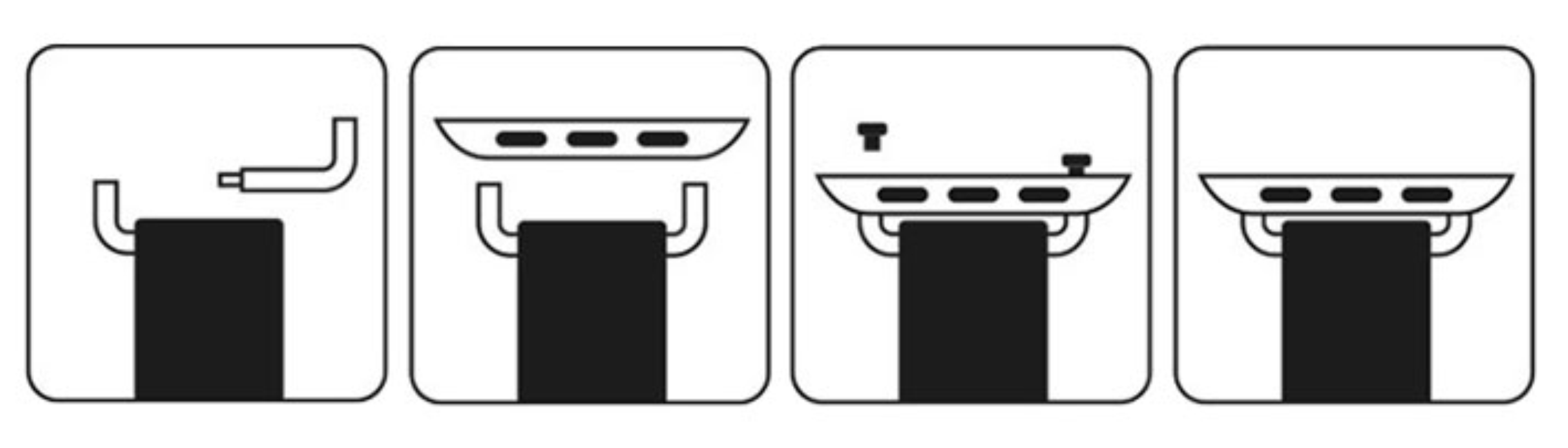

    I agree that the pics on Apple's site don't suggest a replacement strategy.
    However, after some Googling, I found a replacement kit from Baseus that seems to offer a tool, some bolts, and replacement instructions for removing Apple's band.
    It appears that the classic buckle band's attachment "rails" may be a two-piece unit that unscrews from the case module??
    Although I'm not a huge fan of Baseus' band, this seems to open up lots of DIY possibilities, no?

    does the bar where leather strap is attached a spring bar or is it in two part with screws?

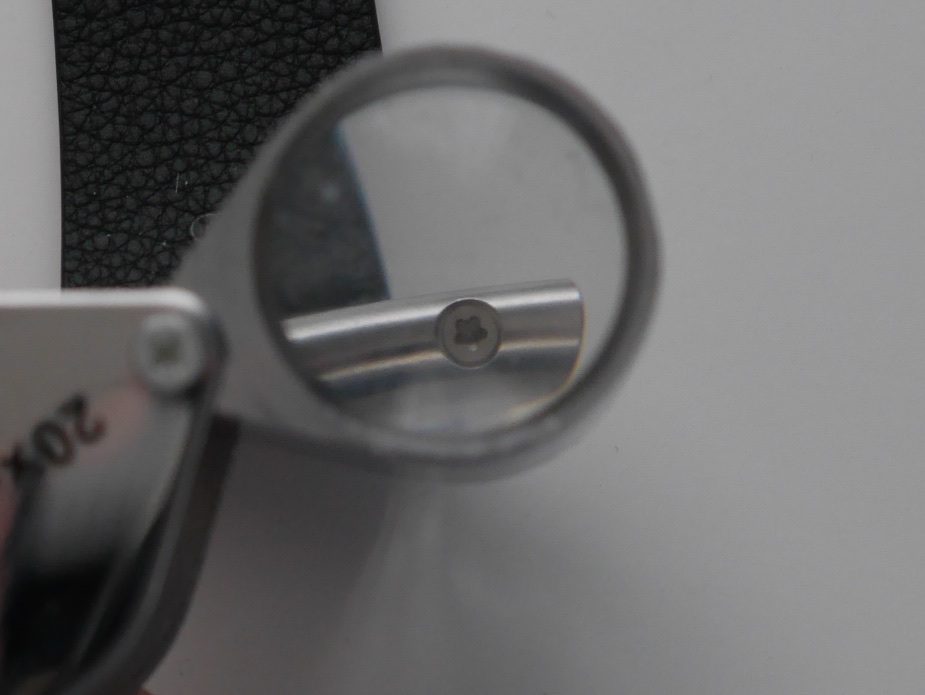

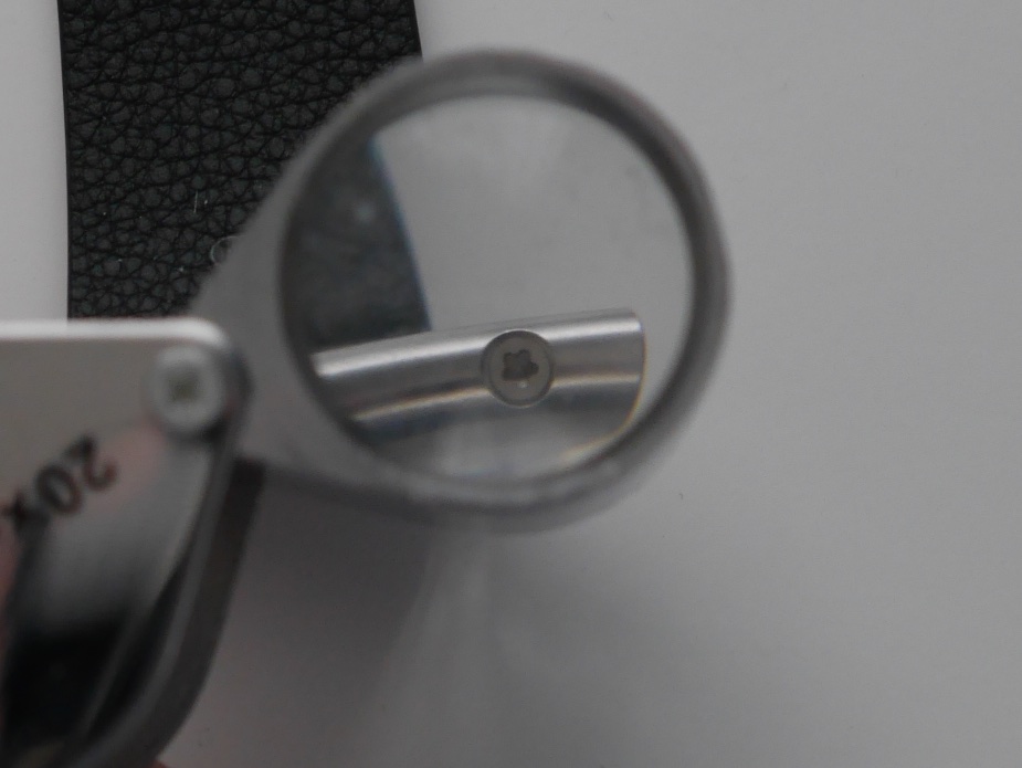

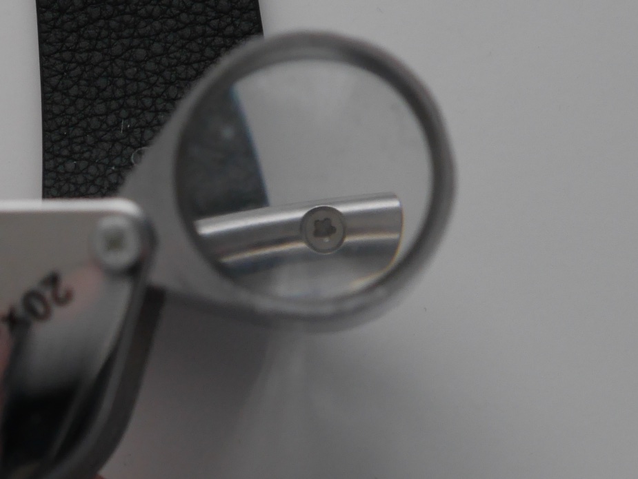

    The loop it is attached to the bar by tiny star screws, so should be possible to remove them if you have a small enough tool.
    It looks like the Baseus kit comes with the right tool and same kind of screws as shown in the picture above.

    Thanks this is a great help really thanks again!

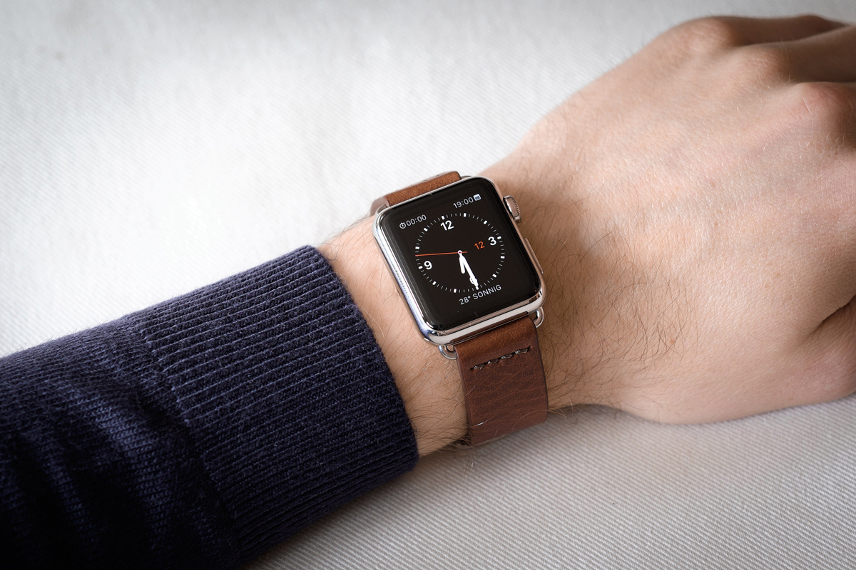

  20. Thyraz macrumors newbie
    Joined:
    Jan 11, 2010
    #20

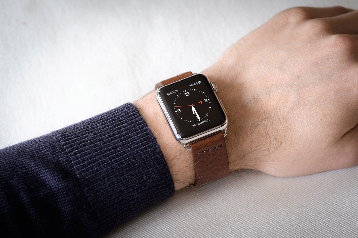

    Worked. :)
    Ordered simple leather straps for a normal watch and removed the screws with a screwdriver of a mobile repair kit I bought some time ago for my iPhone.
    [​IMG]
  21. dtjay7 macrumors regular
    Joined:
    Jul 25, 2008
    Location:
    N. CA
    #21
    Thanks for the information. Is the bar through the strap in two pieces?? Thanks :)
  22. techno-Zen macrumors 6502a
    techno-Zen
    Joined:
    Apr 27, 2015
    Location:
    Gilbert, AZ
    #22
    That looks awesome, what width of band is that?
  23. mattopotamus macrumors G5
    mattopotamus
    Joined:
    Jun 12, 2012
    #23
    link to band?
  24. Thyraz macrumors newbie
    Joined:
    Jan 11, 2010
    #24
    Yep, works exactly like in the image in post #8 in this thread.
    It's a 20mm band on a 38mm watch. I guess the max width for a 38mm watch will be 22mm.
    It's from a small marketplace seller on Amazon Germany. Couldn't find it in the US store.
