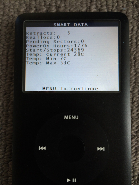

Looks like my hard drive is in good shape for its age.

Hope this helps. And yes, looking at your smart data HD specs, your hard drive
looks like it's still good to go. Hopefully in your case it is in fact the battery,
and I'd suspect with the age of it and the power-on hours you have on it,
that it is in fact the battery. It's probably sloping down on the power curve
really fast, making the ipod act abnormal, which is typical of a battery no
longer capable of holding a good charge.
