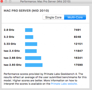

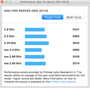

the app mactracker show's your setup to be slower than my 5.1 with a 6c/12t 3.33ghz cpu in both single thread and all core!

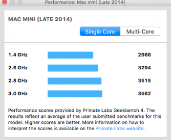

even the old mac min in all cpu options shows faster single core speeds in geekbench
