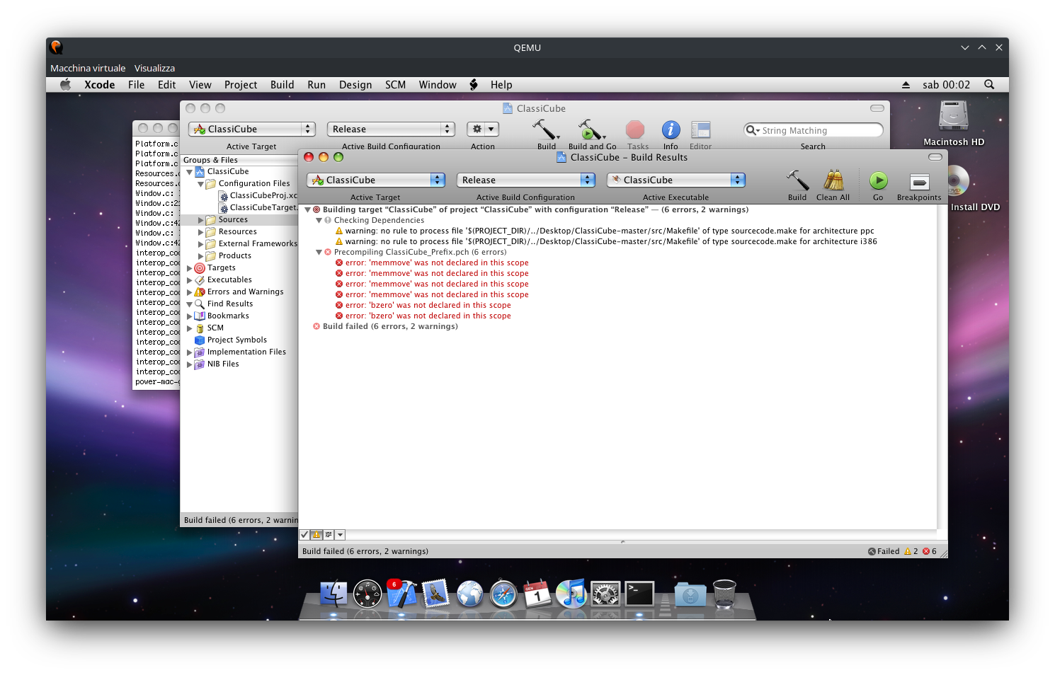

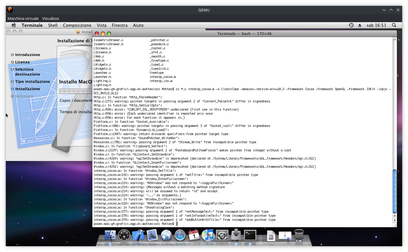

He says:
Warning: Building for intel with Mac OS X < 10.4 is invalid;
Error: implicit declaration of function;
Warning: sending ‘CCwindowDelegate *’ to parameter of incompatible type ‘id _Nullable’;
Warning: incompatible pointer types sending ‘CFStringRef’ (aka ‘const struct __CFString *’) to parameter of type ‘NSString * _Nonnull’ [-Winconpatible-pointer-types];
Build it on a PowerPC Mac.
what if I compile it for Panther using an PPC emulator with Mac OS X 10.4? (such as QEMU)
ok, after some weeks I'm start to setting up the virtual machine using QEMU for arch linux (recently I moved from Windows 11 to Arch Linux) and I had some problem to get the source code from internet, so during evening (it's 22:12 in Italy) I'll spend some time trying to setting up Leopard from the original retail dvd I have.
what mean those errors?

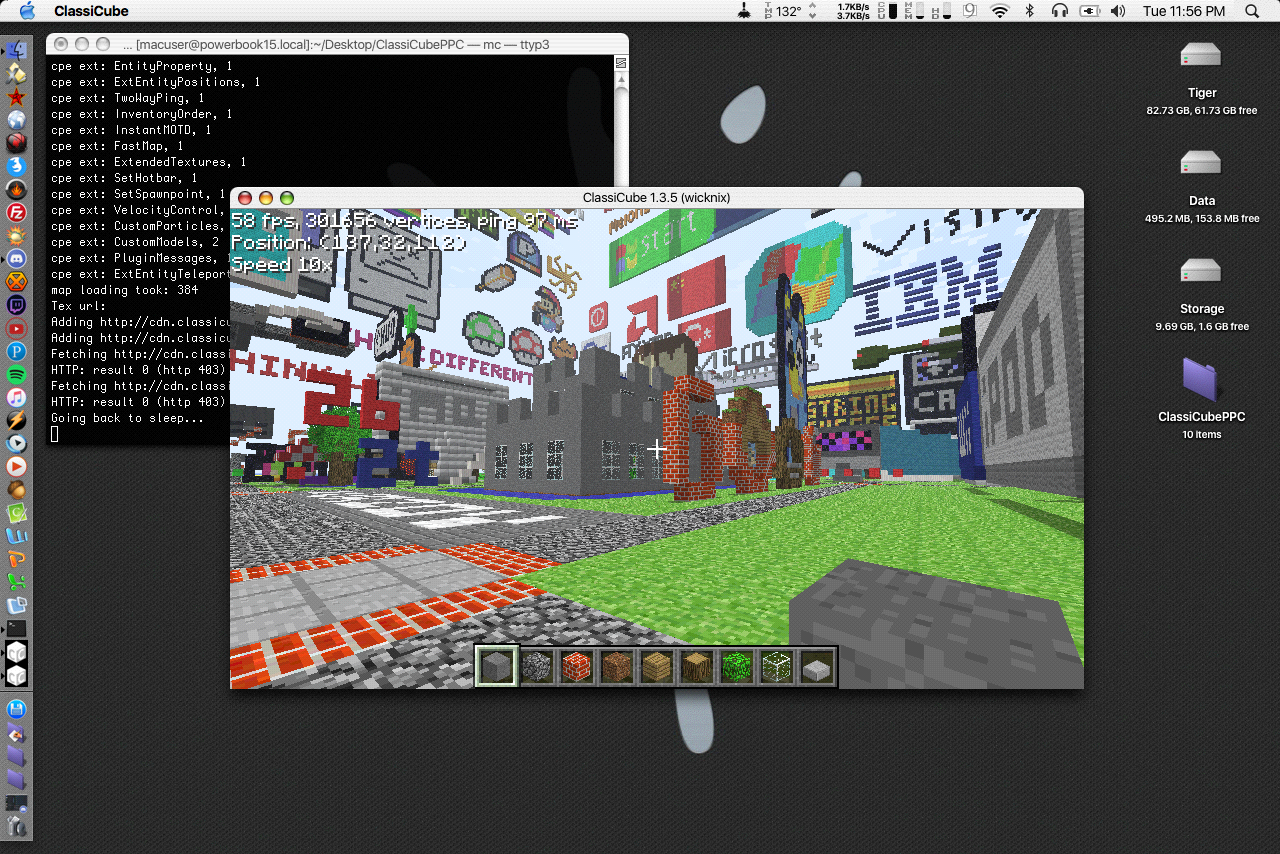

EDIT: same result, but what is the purpose of http.c?
Http.c is responsible for authentication with the ClassiCube infrastructure. I tried to fix this in my fork so it’d work on Tiger like it does everywhere else… apparently I’ll have to roll that back if it cannot compile.
Unable to play Minecraft on lower end G4’s or G3’s? There’s a solution to that! Enter ClassiCube: a continuation of Minecraft Classic written in C. Relatively recently I had the opportunity to get it compatible with G3’s through persistence. It runs with about 20 FPS on a 500 MHz G3! https://home.macintosh.garden/~retroreviewyt/classicube-ppc.html

For those interested, i just built ClassiCube 1.3.5 (latest) for 10.4 / 10.5. It's download #5 on the garden.
It includes 2 versions. 1 for G3's, and 1 for G4/G5's.
It also *might* run on 10.3, but i have no way to test it.
