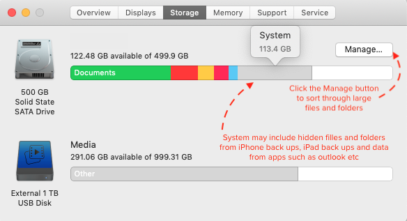

Before you start reinstalling, have you tried the storage management tool in the "About this Mac" menu? see screen shot below
Often there are some large video files or other media that can be moved to an external drive? I like to keep about 30% of my drive clear for best performance.
It is possible that your OS is not corrupted and just acting strange due to being too full?
