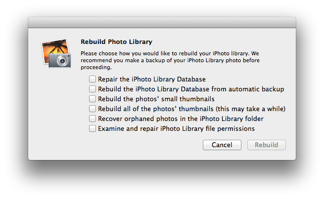

If you hold the option-command keys and keep them pressed then launch iPhoto, do you get the window to repair it?

If it helps at all, I tried to follow these directions since I seem to be having the same problems, and I realized idvd is having the same problem
https://discussions.apple.com/thread/2658126?threadID=2658126
however I do not see any pkg file with 'iPhoto' in it. There are a number of files with 'ilife' but nothing with iPhoto or idvd
EDIT: YES! It finally works! After multiple deletes and reinstalls, for whatever reason its launching now. Thanks.

Try re-installing iPhoto then. I'm not sure why it won't launch. Sorry I was not much help. Sometimes the quickest solution is just to reinstall. Or wait until others come up with another solution 🙂
You did try the simple thing of deleting the iPhoto .plist from preferences?
Thanks for the help mrapplegate. And yeah, for some reason it took like 3-4 reinstalls but it works now lol 🙄
