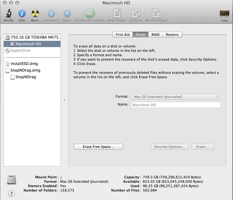

Having issues with doing a clean install of Lion. Followed all the guides, but it doesn't seem to be working out for me.
I've burned Lion on to a disk.
Guides tell me I should go to Disk Utility and erase my HD, well I can't, ERASE is greyed out so I can't click on it.
So not sure what to do, what I'm wanting to do is totally erase my HD, and do a clean install of Lion from the disk.. Any help? 🙂

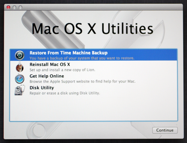

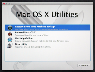

Yeah, you have to boot into the Lion DVD or USB drive you created. Once booted into that....you will see a menu allowing you to run Disk Utility. From there you can wipe your original drive. (You do have backups correct 😉)

Mac HD and Recovery should be your internal disk.
I'm assuming Mac OS X is the DVD or USB stick you created? If so....boot to that. You should get to a screen that looks like below.
