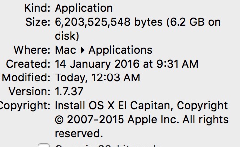

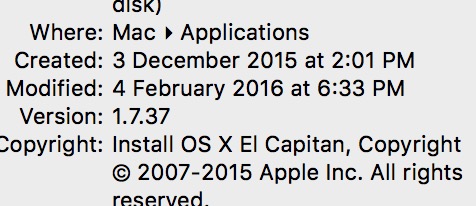

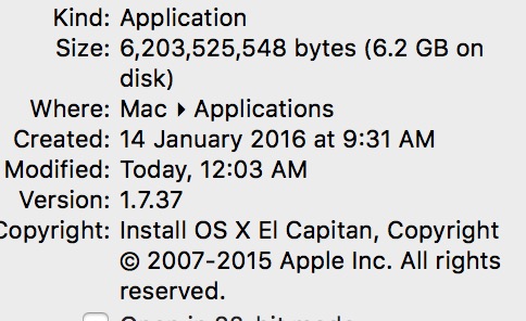

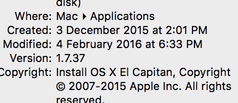

I didn't see it was 11.2 till I burned it to a stick with diskmaker X5 and it labelled it 11.2, I deleted it and redownloaded and it still says 1.7.37
Screen Shot 2016-02-06 at 9.05.52 PM.jpg Screen Shot 2016-02-07 at 7.24.07 AM.jpg
Yes, what you show is not the current version. Download again to get the current version.
View attachment 614505 View attachment 614614
This may sound strange, but have you tried restarting your computer after the download. I have found that sometimes El Capitan does not reliably show the new version number of an app until after a restart.
The created date of 3 December (actually 2 Dec. US) (first graphic) is the correct date for OS 10.11.2. The Created date of 14 January (actually 13 Jan. US) (second graphic) is the correct date for OS 10.11.3.

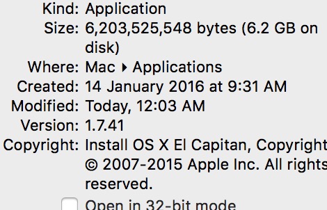

I burned a new usb stick with diskmaker and it correctly showed 11.3, then i did a restart and the getinfo box is now showing 1.7.41 for the same install file. So there you go.
